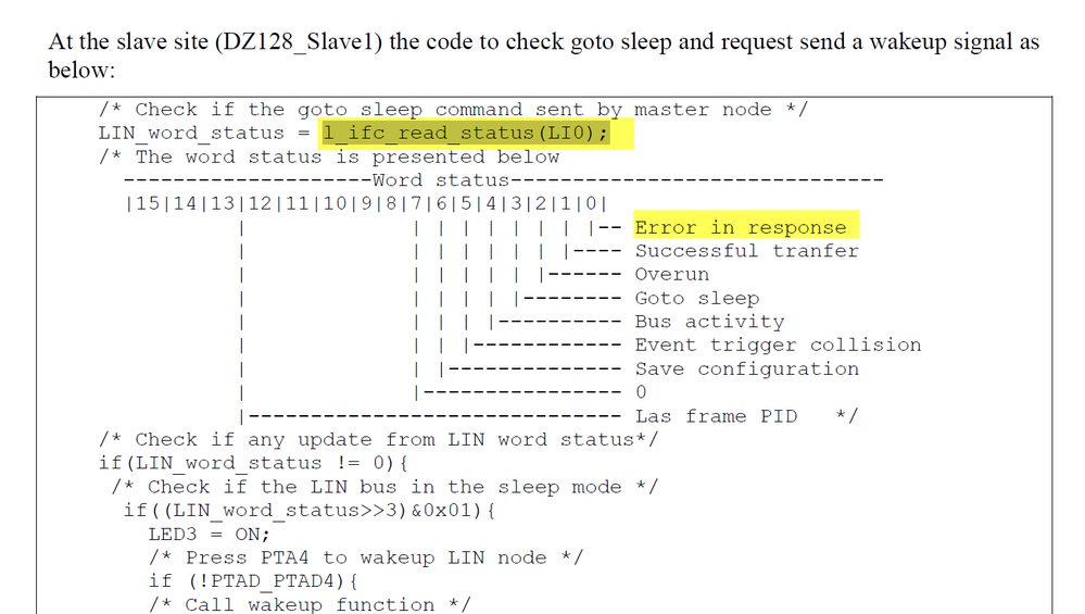

   The slaver node should send the response_error signal to master node. Then I don't know how to get the error status of LIN bus? I am using the LIN stack (LIN_Stack_Package_4.5.9).
   I will appreciate it, if you can give me advice.

Hi Guofeng,
   You can check the LIN status, from the LIN stack user manual, I find the following code for your reference:
Wish it helps you!
Kerry
