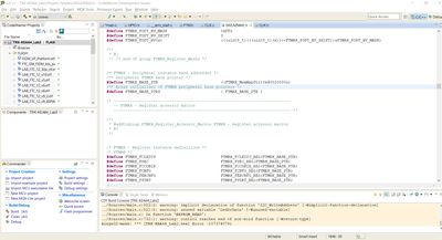

Hi! I'd like to know how to code for configuration, writting and reading EEPROM in a KEA64 (S9KEAZN64A).
My "bus CLK" = 20MHz
I already have the reference manual and I'm in chapter 18.
It could be very helpful if someone could share me an example code too please.
I'm working in CodeWarrior

Sorry I didn't make it clear:
I did not find example for KEAZN64, but I think you can refer to the EEPROM_demo of KE02. Download the FRDM-KEXX Driver Library Package
Then you should be able to find the example (C:\Users\nxa07315\Desktop\FRDM-KEXX-Driver-Library-Package\ke_drv_lib\build\cw\ke02\EEPROM_demo)
This project is based on CodeWarrior. You don't need to download the Keil package.
KEAZN64 is a derivative from KE02Z64, so you can use it.

I already downloaded the Package, and I have the EEPROM project in my workspace, I took the flash.c and flash.h to my project but there's some failiures,
is it really needed to add the common.h and the arm_cm0.h?
4,292件の閲覧回数
Robin_Shen
You may need to manually modify the EEPROM API in flash.c so that it does not depend on common.h and the arm_cm0.h
Sorry for the inconvenience we bring you!
These TRK-KEA64_LABTS1\2\3\4 examples contain only a few peripheral(UART\FTM\ADC\KBI) drivers.
Have you considered what to do if you need other peripheral drivers?
Maybe you should use Processor Expert to create a KE02 40MHz project, and then add the peripheral drivers you need.FLASH_LDD.png
