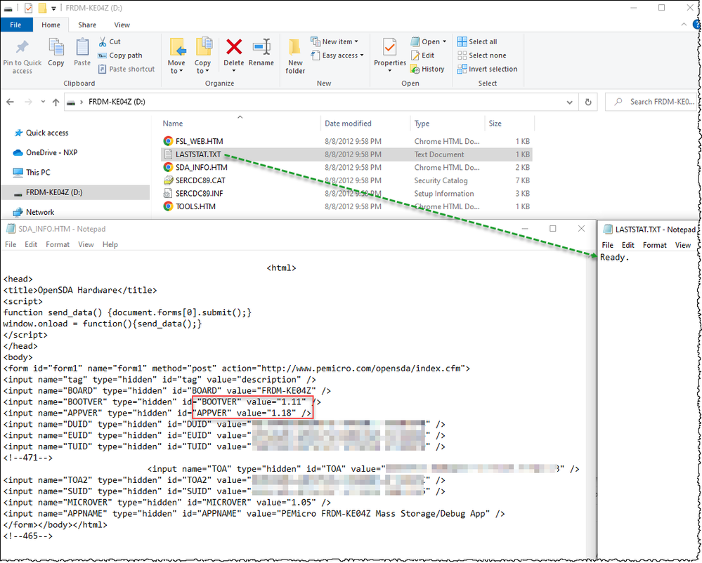

Robin_Shen
Here is my FRDM-KE04Z, you can see that the bootloader and application firmware of OpenSDA  have been updated to BOOTVER=1.11 and APPVER=1.18. Check that LASTSAT.TXT shows Ready.

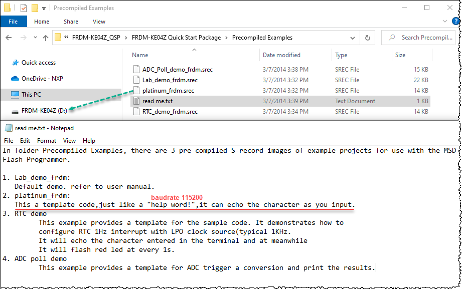

After drop platinum_frdm.srec to FRDM-KE04Z, the RGB led will blink. And it will echo the character as you input.(115200,8,n,1).

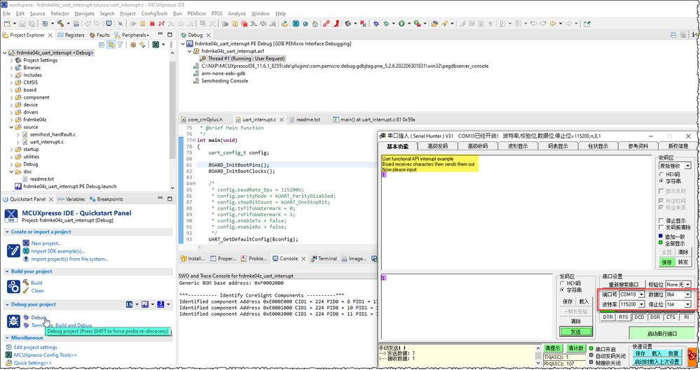

Then I try to debug the frdmke04z_uart_interrupt example in SDK_2.11.0_FRDM-KE04Z with MCUXpresso IDE v11.6.1_8255. Able to debug the project and the result matches the description in readme.txt.
By the way, can you re-discover the probe by pressing SHIFT+Debug after restarting the computer?
