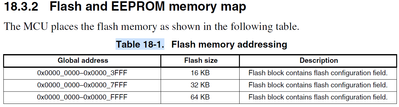

MartinFalcon95
Hello. I see this image in the datasheet but, I don't see where EEPROM memory start, between which directions EEPROM is available? (where does it start and where finish it?)
Thanks.
4,087 次查看
Robin_Shen
Please read the "Table 4-1. System memory map" of S9KEA64Z64M20SF0RM, KEA64 Sub-Family Reference Manual - Reference Manual
