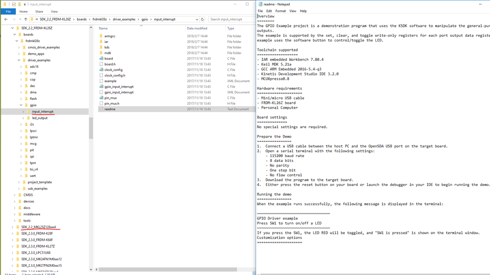

I am in need of a simple push button interrupt. I have searched high and low and tried may example however, I just cannot get anything working. Can someone provide me a working example? I just need a push button that goes to ground and interrupts my program and does a few things thats it.

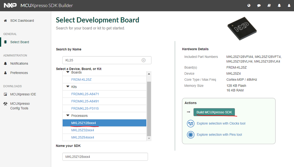

Please download the SDK_2.2_MKL25Z128xxx4 and SDK_2.2_FRDM-KL26Z package refer Generating a downloadable MCUXpresso SDK v.2 package.
And then you can find the gpio input_interrupt example in it's folder. (For example: C:\SDK_2.2_FRDM-KL26Z\boards\frdmkl26z\driver_examples\gpio\input_interrupt)
