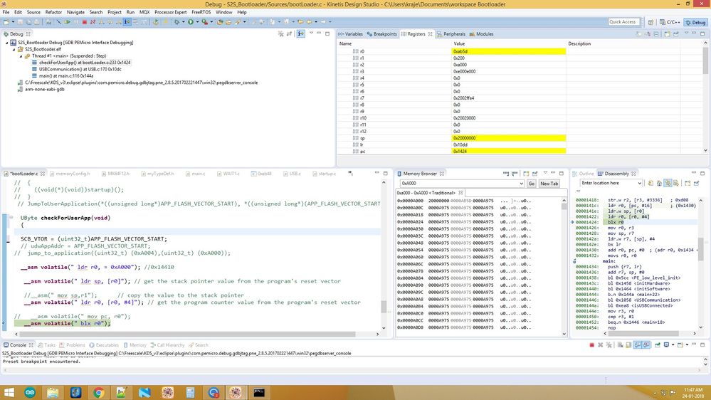

I have written a boot loader and application code using KDS 3.2 for K64FN controller.
My boot loader starts at 0x00000000 and application starts at address 0x0000A000.
My boot loader is able to flash application (S19 file) in application area. After
firmware flashing, I am using below function to jump to application start -
APP_FLASH_VECTOR_START - 0x0000A000
UByte checkForUserApp(void)
uint32_t startup; /* assuming 32bit function pointers */
startup = ((uint32_t*)APP_FLASH_VECTOR_START); /* this is the reset vector (__startup function) */
if ((startup!=-1))
/* we do have a valid application vector? -1/0xfffffff would mean flash erased */
((void(*)(void))startup)(); /* Jump to application startup code */
I have also tried below code to jump to application but it is not able to jump to
0xA000 address.
__asm(" ldr r0, = 0xA000");
__asm(" ldr r1,[r0]"); // get the stack pointer value from the program's reset vector
__asm(" mov sp,r1"); // copy the value to the stack pointer
__asm(" ldr r0, = 0xA004"); // get the program counter value from the program's reset vector
__asm(" blx r1"); // jump to the start address
The value at startup is 0xAB5D which is Program counter's value.
My issue is that, boot loader is not able to jump to application and is jumping to
thumb startup function.
did some one come across this scenario. Any help is appreciated.
Kirti

Hi Kirti
The following code jumps to the application correctly (M4 processor).
// Allow the jump to a foreign application as if it were a reset (load SP and PC)
extern void start_application(unsigned long app_link_location)
    asm(" ldr r1, [r0,#0]");    // get the stack pointer value from the program's reset vector
    asm(" mov sp, r1");         // copy the value to the stack pointer
    asm(" ldr r0, [r0,#4]");    // get the program counter value from the program's reset vector
    asm(" blx r0");             // jump to the start address
Call with:
start_application(0xa000);

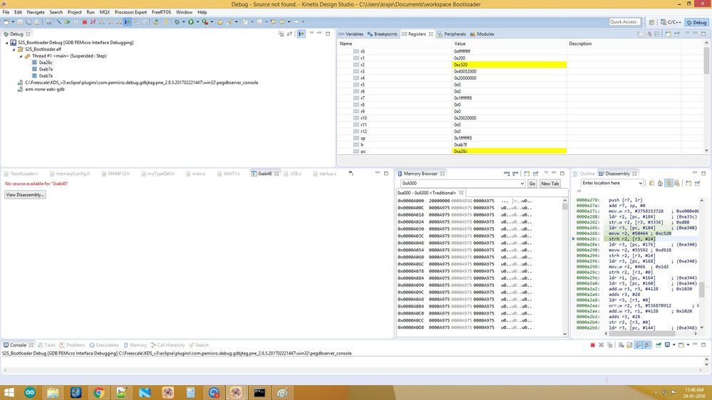

kirtiraje
Hi Mark,
I have implemented extern void start_application(unsigned long app_link_location) function,still it is jumping to _thumb_startup()  in startup.c file. Please have a look at attached screenshot.
9,703 Views
kirtiraje
Hi Mark,
I did debug in single step in disassemble mode and my SP is getting loaded with 0x20000000 and PC with 0xab5d. It is jumping into application but after execution of instruction at address 0xA28c it is switching from application to thumb_start() function of boot loader startup.c. Below are the screenshots showing 0x20000000 loaded in SP in image1,  it is jumping to application in image2, and again switched to boot loader thumb_startup().1.jpg2.jpg3.jpg
I am using KDS 3.2 and openSDA to debug the boot loader.
Can you help me to find out what could be wrong at  address 0xA28c, so that it get redirected again to boot loader.
9,703 Views

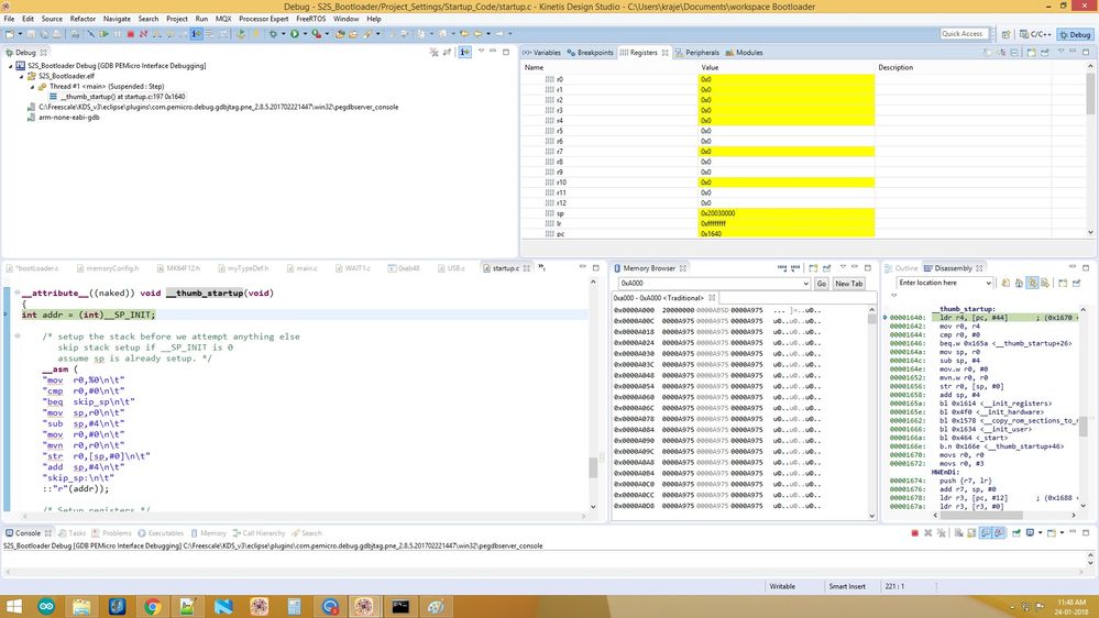

kirtiraje
Hi Mark ,
I did debug the application code. At address 0xA28c in application code is the watchdog reset instruction in init_hardware(), you can see that in the below screenshot.4.jpg
When I debug application, It is properly running the application. As I said while running boot loader mode, it is jumping to application and then at address 0xA28c it is again switching to boot loader thumb start function. Can any one help me in finding the solution.
9,703 Views

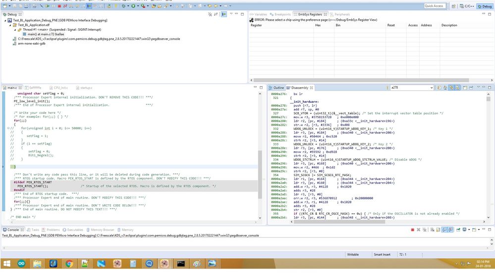

mjbcswitzerland
Specialist V
Kirti
It looks like the watchdog unlock code is too slow.
When unlocking the watchdog for modification the keys needs to be written quickly otherwise the watchdog will reset (to protect the system against watchdog manipulation). I have seen similar issue in Teensy watchdog code which works after a reset but not later (when the clock is running at full speed).
Since you have disabled the watchdog in the loader code (if the same as the code you show) you could just remove the same code from the application so that it doesn't disturb.
Otherwise, build the code with full optimisation to make it faster. Or replace the code with assembler to ensure to avoid the inefficient accesses that are presently being performed (load the two key values to two registers and then write the two registers to the watchdog registers immediately after each other).
Finally, ensure that interrupts are disabled at this point to avoid the unlock sequence from potentially being interrupted.

kirtiraje
Hi Mark,
I have commented the watchdog disable code which is there in cpu_init.c file of application code
The code I have commented is -
// #if STARTUP_WDOG
// WDOG_UNLOCK = (uint16_t)STARTUP_WDOG_KEY_1; /* Key 1 */
// WDOG_UNLOCK = (uint16_t)STARTUP_WDOG_KEY_2; /* Key 2 */
// WDOG_STCTRLH = (uint16_t)STARTUP_WDOG_STCTRLH_VALUE; /* Disable WDOG */
// #endif /* STARTUP_WDOG */
I did disable the interrupts.
Then I did debug the application, but It did not run the application (LED blink)  (not from boot loader code).
If I uncomment the above code then the application runs fine (not from boot loader code).
Please let me know your comments on this.
Kirti

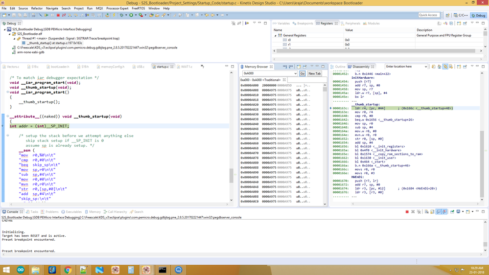

mjbcswitzerland
Specialist V
Kirti
I see that you have 0xab5d at 0xa004 and so I expect it to jump to here.
You need to single step the jmp code and check that 0x20000000 is really in the SP before the jump takes place.
Single step in disassemble mode since the debugger may otherwise become confused when it tries to follow using source level debugging.
Mark
