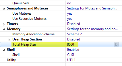

Hi Victor
You need to increase the heap size to a higher value in the FreeRTOS component:
So you know why this happens:
Each of your task is using space in the heap.

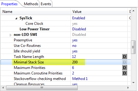

This is the value you are using in your call to create the task (configMINIMAL_STACK_SIZE).
This size is in 'stack addressable memory uints', so 4 bytes for each. So if you have a minimal stack size of 200, this means 800 bytes per task (plus some bytes for the header information, etc). Additionally to the two task you create, there is as well the IDLE task created at scheduler start. So if you have 2 KByte of heap size, this will get you that out of heap error.

victorleite
Thanks guys! That was exactly my problem!
Erich, you're awesome! Thank you for this simple and powerful explanation!
