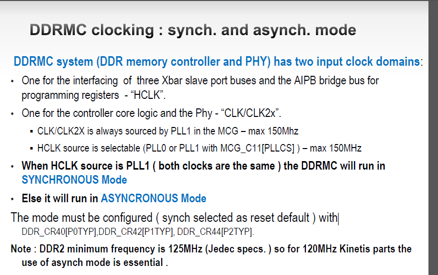

Request you to give details on how to select  external crystal values so that I can operate MK70FN1M0VMJ12 at 120MHz. I was going referring  the Tower board schematics in which two
crystal were used
i.e. 12 MHz and 50MHz and I want to know based on what factors these 2 crystals (12MHz and 50 MHz) were chosen and also want to know if single crystal is enough to operate MK70FN1M0VMJ12 at maximum speed of 120MHz.

You might have referred to TWR-K70F120M, so you have question why 50MHz and 12MHz are selcted, actually, 50MHz is for Ethernet application when RMII interface is used, because when the K70 Ethernet MAC is operating in RMII mode, synchronization of the MCU input clock and the 50 MHz RMII transfer clock is important. In this mode, the MCU input clock must be kept in phase with the 50 MHz clock supplied to the external PHY. and 12MHz is for DDRC module and DDRC's PHY, because DDRC module has two modes, sync and async, with the 12MHz crystal, you may get DDRC in sync mode. Please kindly refer to the following for more details.
so if your application doesn't use Ethernet or DDR2 RAM, one single crystal is enough. To calculate the PLL output, you may use the Process Expert of CW 10.6 to simulate MCG module configration, please also note the PLL ref clock is 8MHz at least.

information on this, I am using DDR2-800, NAND Flash (response time is 20 ns
or 50 ns), USB 2.0
for my application but not Ethernet so please let me
know how should I select crystal values so that I will get best response. Want
to know  if I can use either EXTAL0 (PLL0) or EXTAL1 (PLL1) for my
application or I have to use 2 crystals i.e. EXTAL0 and EXTAL1.
Secondly I was going through the document which you shared but
not able to understand the statement “ One for the controller core logic and
the PHY CLK/CLK2x.  CLK/CLK2x is always sourced by PLL1 in the MCG-max
150MHz”.  Request you to give some more detailed clarification on this.

Since you are using MK70FN1M0VMJ12, you may have the following solution for the clock settings:
  1. PLL0 is 120MHz, and PLL1 is 150MHz(possible for 120MHz part), DDRC in async mode;
  2. Just PLL1 is used, and PLL1 is 120MHz, DDRC in sync mode.
with solution 1, you have to use both PLL0 and PLL1, and there can be additional latency when accessing the DDR if you run DDR2 in async mode, so I think you would prefer solution 2, just need one crystal, 8MHz can be selected, but DDR2 performance should be less than spec because DDR2 clock is below 125MHz. so moving to 150MHz part should be better option, though it might cost more... so I think you may start with 120MHz part and switch to the 150MHz if you need additional performance for the system and/or DDR. For 150MHz part, I think you may use a 8MHz crystal as well, but to get the 48MHz USB clock, you can not set PLL1 output 150MHz, but 144MHz instead, because of the ratio determined by SIM_CLKDIV2[USBFRAC,USBDIV].
For your question, I think you may refer to RM's "Chapter 5 Clock Distribution-> 5.7.5 DDR Memory Controller Clocking" and "Figure 25-1. Multipurpose Clock Generator (MCG) Block Diagram", you may find more details regarding CLK/CLK2x.
