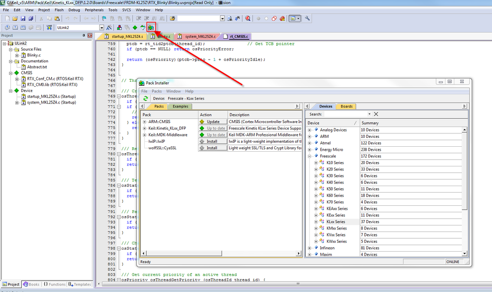

BTW: I am using Keil provided KL25 example projects, which downloaded from [Pack Installer], below picture shows detailed info:
Wish it helps.
