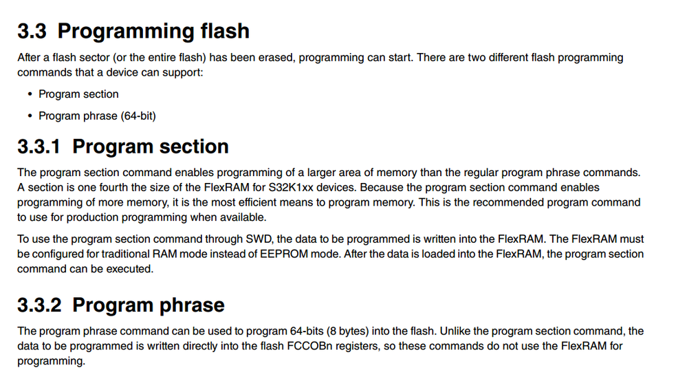

I am currently trying to program the S32K118 board using the SWD interface.
I refer to the AN12130 documentation, and this blog.
I am able to access the MDM-AP & AHP-AP port .
The mass erase command can be executed correctly through the MDM-AP port.
But now I have some problems......
After I use the mass-erase command by MDM-AP, I can't read the value of any register anymore.
I tried to write 0xC0000000 on the PCC FTFC Register (PCC_FTFC), but it didn't work.

There are detailed steps in the application note that you mentioned.
Once the MCU is mass erased, you can read the MDM-AP Status[2] bit to see if the MCU is unsecured.
You need to set the debug request bit (MDM-AP Control[2]) before releasing the reset.
