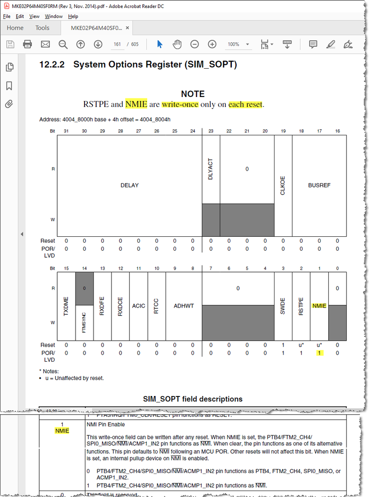

Hi, everyone! :smileyhappy:
I'm using a KE02Z64 to read the frequency from a signal generator, I'm reading the signal in PTB4 with the FTM (FTM2_CH4). The thing is that when I load the firmware with the debugger, the application runs perfectly (while the debug session is running) and I can read the frequency from the generator, once I stop the debug session and restart the micro I can´t read anything and my aplicaction never enters to the FTM Interrupt.
Does anyone know what I'm missing?
Pablo.
Tags (3)
1,336 Views
Robin_Shen
Hi Pablo,
Notice the SIM_SOPT[NMIE].
Robin
