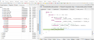

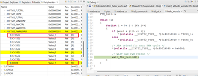

No, your understanding is wrong. I did a test, please see the result:
1) with the correct 0x0200=LDOK:
2) with the wrong 0x0020=LDOK:

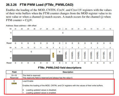

I’m afraid you’ve mixed up byte order and bit numbering. For a 32-bit register, the documentation refers to fields by bit (bit0 is the least significant, bit31 the most significant). LDOK = bit9 has nothing to do with which byte it’s in.

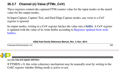

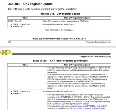

When FTMEN = 1 (which you have already set), the main registers of the FTM (including CnV, MOD, CNTIN, etc.) are write-buffered; the actual registers are only updated when a synchronization/load event is triggered. Otherwise, the new values will remain in the buffer, and the channel will continue using the old initialized values. Please see the description in RM:
Please modify the code below to set LDOK=1 to enable the load:
            /* ARM reload for next PWM cycle */
            *(volatile __UINT32_TYPE__ *)0x4003A098 = 0x0201;//0x0200=LDOK, 0x0001=CH0SEL
Hope it helps.
Hope it helps.
