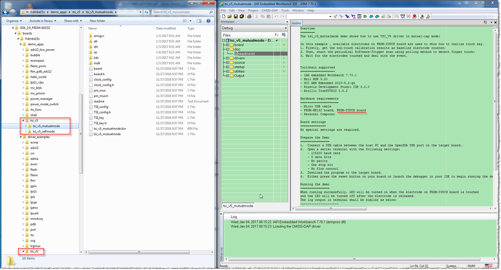

Hi there
I bought the FRDM-TOUCH. Is there any sample code to get started with?
The Quick Start Guide says that there is software and documentation under "Jump Start Your Design" at www.nxp.com/FRDM-TOUCH. However, this site cannot be found.
1 回复
1,123 次查看
Robin_Shen
Hi Tobias,
Please refer the tsi_v5 examples in SDK_2.0_FRDM-KE15Z.
Select FRDM-KE15Z then download SDK_2.0_FRDM-KE15Z.
You can getting start with KSDK reading "How to start with KSDK".
