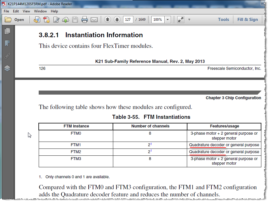

Please check the chapter 3 in Reference Manual first to ensure wheteher the FTM module has the Quadrature decoder feature or not.

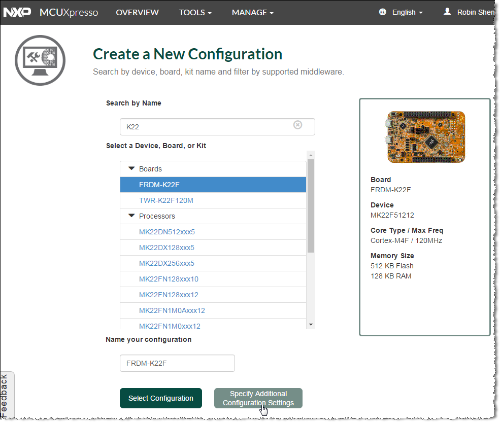

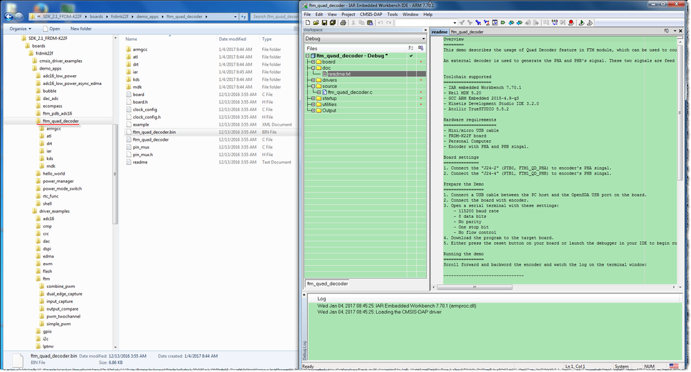

You can refer the demo "ftm_quad_decoder" in KINETIS-SDK.

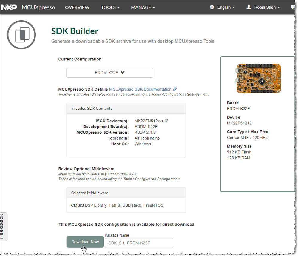

For example: search K22 then select FRDM-K22F and download SDK_2.1_FRDM-K22F.

NOTE!  FTM0 is NOT (at least in most Kinetis parts!) QD capable --- check chapter 3 of the appropriate Reference Manual under FlexTimer Configuration, Instantiations-table.  And of course quadrature-edge-counting requires two channels, A and B:  QD-capable FTMs always seem to be exactly two-channel, so those connect to both 'channel pins'.  QD mode DOESN'T, however, use them with any channel LOGIC --- you can use THOSE blocks to capture both edges of an INDEX indication.
