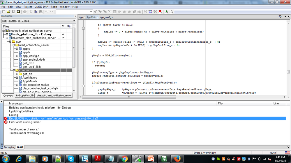

hello there ,
i imported KW40 project in iar workbench.i am facing iar workbench error as below.iar error.png
can anyone help me??
2,746 Views
jeremyzhou
Hi ,
IAR Undefined external messages for inline functions has explained the compiled error, please refer to it for details.
I was wondering if you can upload the project, then I can replicate the issue on my site and it can help me to figure out the root cause of the issue.

shailavsurve
ok thanks for your support. i am uploading project here:https://www.dropbox.com/s/0kcrb0mf80fcfe6/bluetooth_heart_rate_sensor.rar?dl=0
can you download this project??
2,746 Views
jeremyzhou
Hi Shailav Surve,
After double checks, I think the uploaded project had already been modified.
So I was wondering if you can share the path that the project resides in, then I can open the project on site and I've already built several demos, they don't have any error messages after built.
Ping
2,746 Views
egoodii
Senior Contributor III
Is your outermost layer procedure named 'main', per C standard?
