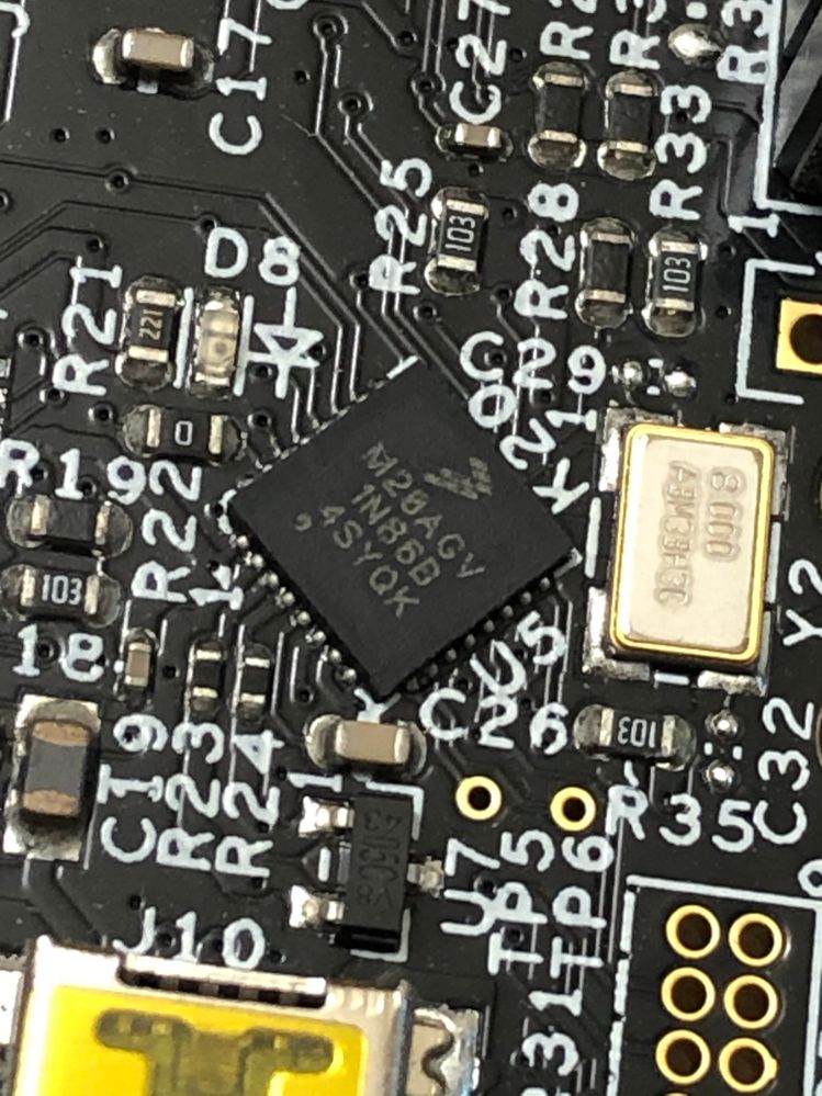

Got a FRDM-KL26Z from Digikey and it's dead on arrival. Connecting the device to power via USB reveals no activity. Documentation indicates that there's a demo onboard. No evidence of any such thing with this board. Connecting it to a Mac and running USB Prober reveals that there's no device connected to the Mac. No activity on the board when powered in any way. No MSD. No change when holding down reset.
Digikey was very kind to send a replacement. It's just as useless.
What's the deal?

Hi Frotz,
Yes, M20AGV is belong to MK20DX129VFM5.

Hi @phatpaul ,
I said it was the MK20DN32M5 because that is how the USBDM programmer identified it (using chip ID). I guess it's possible they also put the wrong chip on these boards...
I have found my old KL26Z under a pile of board: Here is a picture of the K20 on it:
I would not trust what USBDM tells you. If you can, I recommend using a J-Link instead.
I hope this helps,
Erich

Frotz
I've been trying all sorts of things to get this board to work (and its replacement) and have found the DAP to be "flakey." I was able to get the J-Link to halt the K20, erase the flash and re-program it using Segger's FRDM-KL26Z OpenSDA firmware—which locked the chip, but still the onboard DAP does not present itself as useable anywhere and the green LED does not work. I only got this far on one of the two boards, the other is not at all cooperative. And I was only able to get the one board to cooperate for a few minutes and since has been just as useless as the other.
It would seem that the KL26 on each board was not programmed b/c the onboard K20 DAP is unreliable at best.
Can someone at NXP comment on this and have a look at the picture below showing lot#, S/N etc let me know how I can get a FRDM-KL26Z that is in proper condition?
Thank you,
Andre.
