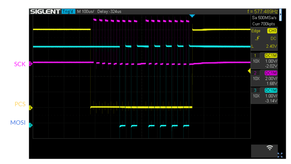

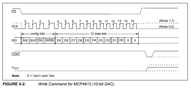

I am having some trouble using the SPI module on my FRDM-KEA128. I am trying to change voltage output on a MCP4912. I compared my SPI signals to an example on the datasheet. They seem correct to me, but I'm still not detecting any voltage change. Is there anything I am missing?
The following image is me trying to send two bytes: 0xFA and 0xAA. I tied LDAC pin to ground, so voltage should be updated when a 16bits message is received.

The image uploaded of the oscilloscope shows the 0xFA and 0xAA, the SPI seems right, from KEA128, this can be an issue with the MPC, you need to consult the datasheet from the MCP or contact the vendor of that device. I suggest reviewing the velocity of the MCP has support.

Hi Pavel, Thanks! That was the issue. I was sending my SPI too fast. This kind of brings up another question. I am currently using a PIT Timer at 1kHz to call a send SPI message function, but I am thinking whether there is a quicker way to just grab the current clock tick from some registers without setting up the timer handler?
