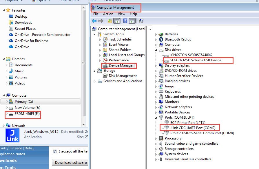

  You also can find JLINK CDC port in the device manager, just like my attached picture:FRDM-K66-JLINK.JPG

I tried your rules but no result. After send 03_OpenSDA_FRDM-K66F.bin to Bootlader(device), PC did not recognize the device and give some error sound like plug-in a device but Windows did not recognize it. While device was plugged in, I take screen shot my device manager tool and add the attachment

From your picture, it seems, the driver install have problem.
