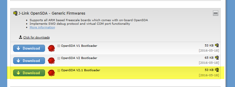

I have a FRDM-K66 board where the open SDA interface has failed.  I think it is the issue described here:
https://mcuoneclipse.com/2016/06/26/how-to-recover-the-opensda-v2-x-bootloader/
I need to recover the bootloader.   When I go here:
OpenSDA Serial and Debug Adapter|NXP
The bootloader and OpenSDA applications are not available for the K66.
Please help!

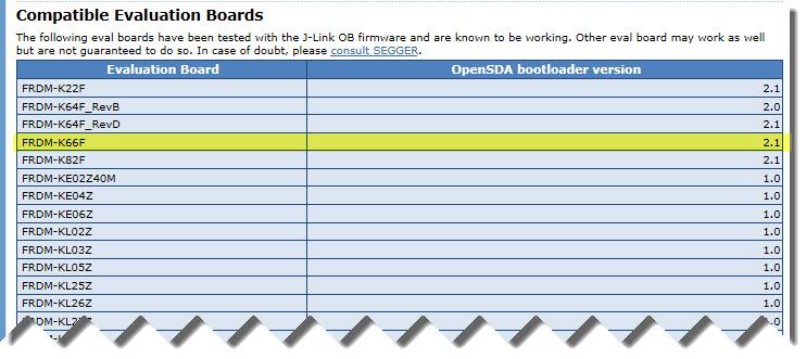

shengrongwu
Hi Eli,
I will second Erich on that. FRDM-K66F has v2.1 bootloader on its OpenSDA circuit, which is the same as FRDM-K22F.
The default OpenSDA applications on FRDM-K66F is Jlink application, which you could get from www.segger.com/opensda.
I am having the web team to add FRDM-K66F to OpenSDA Serial and Debug Adapter|NXP
Roy

BlackNight
Hi Eli,
I don't have a FRDM-K66, so I cannot tell for sure. But it looks like it is using the same circuit and K20 as the FRDM-K22F. So I would flash the bootloader of the FRDM-K22F to the FRDM-K66.
I hope this helps,
Erich
