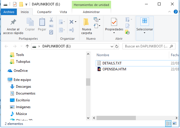

I just acquired a couple of FRDM-K22F dev boards, as soon as I connected them both, the freaking bootloader got corrupted (I'm working on a Win10 PC), I started researching some and then more regarding the issue, I already checked ErichS posts and eclipse site regarding the problem. I downloaded his K20_dx128 Bootloader s19 file from the Github site and programmed the freedom boards using a Multilink Universal debugger in a dummy Kinetis IDE project using the corresping launch config. (so far so good) once I unplug-plug the board it enumerates as bootloader (without having pressed de RST before plugging it) and shows the appropiate 2 files:
Details.txt
# DAPLink Firmware - see https://mbed.com/daplink
Unique ID: 0000000050234e45002d0006eaee000608e1000097969900
HIC ID: 97969900
Auto Reset: 0
Automation allowed: 1
Daplink Mode: Bootloader
Bootloader Version: 0241
Git SHA: be5afd34db2efe1e08d72fa23b3a68ab2625d9a3
Local Mods: 1
USB Interfaces: MSD
Bootloader CRC: 0x439c8da1
Interface CRC: 0xb5ee299c
As far as I can tell it looks good, after that I plug it holding the RST button to enter make sure I'm entering bootloader so I can add the OpenSDA debug tool I dragged the bin: "DEBUG_OpenSDA_for_MBED_Bootloader_by_Pemicro_v2.1.bin" I got from the P&E Micro website, the file transfer seems succesful (green led blinking), once the file transfer is completed the board disconnects, the browser window closes and the red led the middle of the board turns on. If I plug it and unplug it the board fails to enumerate. If I plug it while pressing RST, it enumerates in bootloader mode (previous image).

Hi Erich, I tried using the v2.44 Bootloader fromthe link you provided, first I converted the file to S19 using the P&EMicro Bin2S19 tool (tried the GNU Tool first but it shows invaled bfdname error). The file downloads succesfully but when I plug the USB cable in bootloader mode (pressed RST button while plugginf cable) it enumerates in MAINTENANCE mode:
I open the help link, where it states the DAPLink needs an firmware update. Any thoughts on it? I guess the bin 2 s19 conversion could have gone wrong
