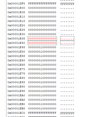

Hello I have two question regarding the FLASH_Program from the fsl_flash files. When the memory is 0xFFFFFFFF (empty) the FLASH_Program is able to write it and  then as the firmware tries to program it again, it fails. And the function FLASH_Program does not crash and the result is  kStatus_Success. Why?

However I am able to erase sectors at the very begining of the application firmware.
5,544件の閲覧回数
carlesls
I try to increase a value on the memory but to no avail... it writes a '0' instead of a '2'...
5,544件の閲覧回数
carlesls
I try to write a 64-bit each time but I am not able to do it.
5,542件の閲覧回数
carlesls
I added the code I use.
5,543件の閲覧回数
carlesls
Thanks, Pavel.
I am using the mke04z8vtg4.
I am using no examples... I am merely using the FLASH_Program function.
