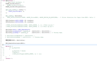

I have a question:
When I enable 2 pins as inputs for keyboards interrupts, the KBI0_IRQHandler does not respond. But it is curious because  I am able to trigger the KBI0_IRQHandler by one pin or another but when I set the both pin, the KBI0_IRQHandler is never triggered...
3,100 Views
carlesls
Another question: Is it possible to change the edge detection (from falling to rising or from rising to falling) at the very interruption?
Thanks a lot again.
3,147 Views
carlesls
This piece of code does not work.
kbiConfig.mode = kKBI_EdgesDetect;
kbiConfig.pinsEnabled = (uint32_t) (0b00010000 | 0b01000000) ;
kbiConfig.pinsEdge = (uint32_t) (0b00010000 | 0b01000000) ; // Rising edge.
But this,
kbiConfig.pinsEnabled = (uint32_t) ( 0b01000000) ;
kbiConfig.pinsEdge = (uint32_t) ( 0b01000000) ; // Rising edge.
or this
kbiConfig.pinsEnabled = (uint32_t) (0b00010000 ) ;
kbiConfig.pinsEdge = (uint32_t) (0b00010000 ) ; // Rising edge.
does trigger the keyboard 0 interruption... but why?
