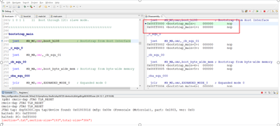

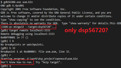

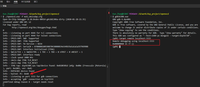

I use Symphony Studio IDE to debug with openocd+gdb56300,The gdb connection was also successful, but there was a problem downloading my program. The openocd connection gdb information is shown below.

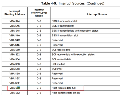

info : halted: PC: 0x60 , This is no running program, pc is equal to 0x60, I queried DSP56303 USER's MANUAL, this value is the interrupt address of a hi peripheral, is it so?
I have connected to dsp core and gdb56300, but the online debugging of the software program seems to be wrong, so the debugging step cannot be performed, and the pc stops at 0xff0000,I guess it's my launcher and ram
