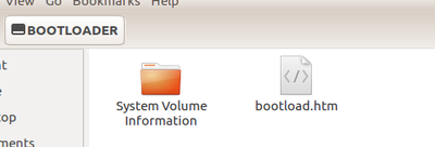

soul26
According to the chart to check if the boot loader is updated, it should appear as "maintenance". Should I still load the files? is there an error in the chart? am I missing something?

jingpan
Can you find a window pc and copy the binary file again? I tested on a FRDM-K64F. It can work.
If you use ubuntu, bootloader version is not important. You can use the original openSDA on the board.
