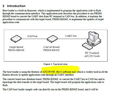

In that documents there is a tool named AN2295 we tried using this tool but we didn't find any software's regarding KE06Z controller.
Kindly help us !!!
Thanks in advance. An2295 toolAn2295 tool
please find the above attachment what we are following ....

7,672 Views
nxf56274
The convert board do not need the bootloader. Your target board need it to get the data from the convert board and write the data to the flash.

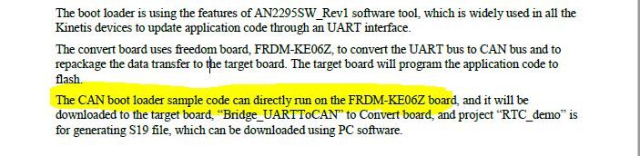

It's okay but again i had find one document it is KE06Z can bootloader from nxp there is document but no code provided please find the attached image ke06z.JPG
i don't know what exactly have to trust

nxf56274
The convert board is not necessary for your bootloader. Because the pc do not have the CAN bus, so we need a board to convert the PC UART data to CAN data. No matter if you use the convert board, the target board must have the bootloader.

Teja114
There must be a CAN bootloader on the target device am i right ?

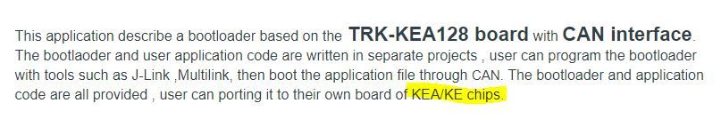

Teja114
Hi there,
now porting is difficult for us can we use KEA128 as a converter board and KE06Z as a target board ?

Teja114
is it possible to port  kea128 can bootloader to KE06Z controller ?
7,704 Views
nxf56274
Sorry, we do not have the can bootloader code for ke06. You can refer the kea128 can bootloader.
