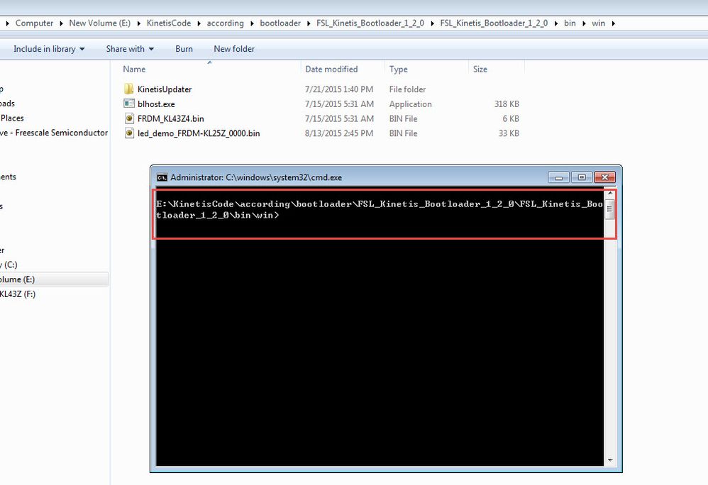

2. Open a command prompt in the directory containing blhost. For Windows OS, it is <install_dir>/bin/win.
3. Ping the COM port in blhost
If you get the current version, you will pin the COM successfully.
4  Erase all flash, and write the KL43 application bin file
All these steps you can find it from Getting Started with the Kinetis ROM Bootloader.pdf, please try it again,  about the FRDM_KL43Z4.bin, you can find it from :FSL_Kinetis_Bootloader_1_2_0\FSL_Kinetis_Bootloader_1_2_0\apps\binaries
You need to copy FRDM_KL43Z4.bin to path:FSL_Kinetis_Bootloader_1_2_0\FSL_Kinetis_Bootloader_1_2_0\bin\win before you write it to your chip with UART ROM bootloader.
It works on my FRDM-KL43
Wish it helps you!

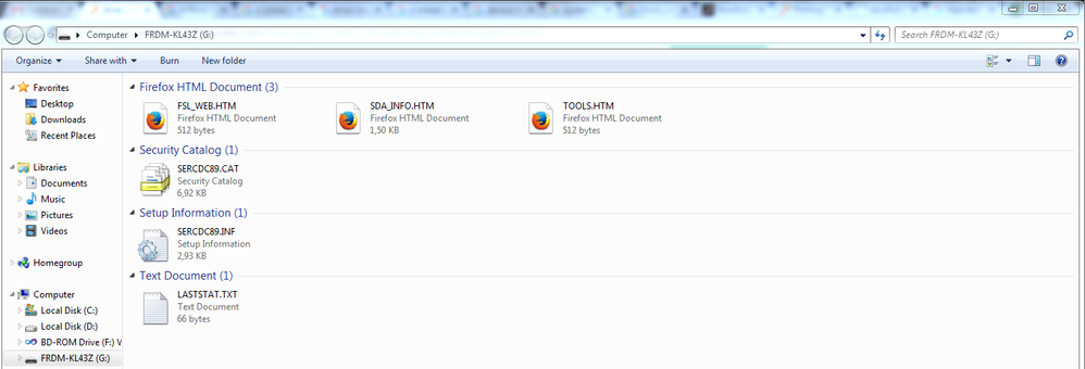

piotrcerba
Thank you Jingjing Zhou, with your project I managed to connect to the board with blhost and program the FRDM_KL43Z4.bin
Do I have the KBOOT bootloader now present on the board?
I am asking because the device still enumerates as FRDM-KL43Z drive and it seems there is no difference from OpenSDA bootloader. It still has .html file that redirects to PEMicro webpage.

kerryzhou
That's very good.
Yes, after you program the FRDM_KL43.bin to your chip, then the code will run your FRDM_KL43.bin code, FRDM_KL43.bin is also from the KL43 driver, so you may see the same phenomena, if you want to see the difference, you can program your own .bin code to it.
  You don't need to care about the .html  file in Opensda, this is just the debugger, just for the code download and the virtul com.

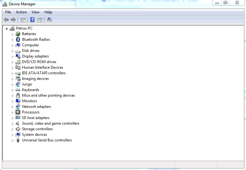

kerryzhou
Hi Piotr Cerba,
    Just like Alice have said, you should refer to the Kboot user guide, you should make sure your board's CDC serial port works ok.
    Please check the serial port in Windows Device Manager, and make sure you have install the serial port driver before.
Wish it helps you!
