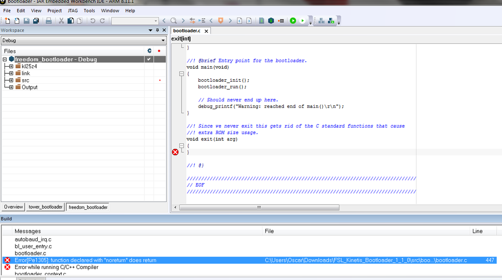

Hi all. i just downloaded the FSL_Kinetis_Bootloader_1_1_0 source code, i did not performed any modifications yet, but when compiling i'm getting the next error: Error[Pe1305]: function declared with "noreturn" does retrun. Can you please advice? I am using the IAR Embedded Workbench IDE - ARM 8.11.1 Best Regards
Please see below:

Hi Oscar Razo
This is a IDE related problem, I test the same code in IAR Embedded Workbench IDE - ARM 7.60.1 and it could compile without problems. Regardless of this, my recommendation is that you use the latest version of Kinetis bootloader, which is the version NXP_Kinetis_Bootloader_2.0.0
Best Regards
