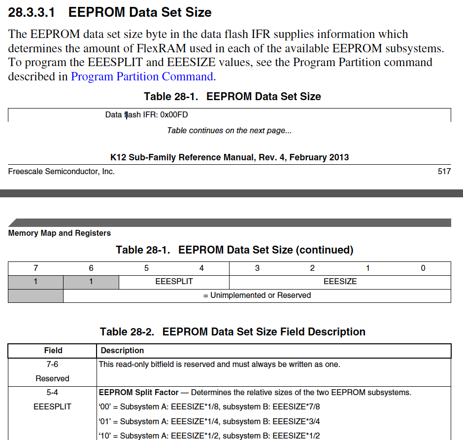

Hi at all,
Can anyone tell me what I to do with the eesplit bits in the eeprom data set size register? In the past, I have
worked with a MK10DX128VLH7 cpu and there weren't these bits?! So do I have to pay attention to these bits?
Especially, when I would like to read and write the EEPROM data?
I only found this description:
Well but what can I do and how can I use the different subsections of the eeprom?
Pascal

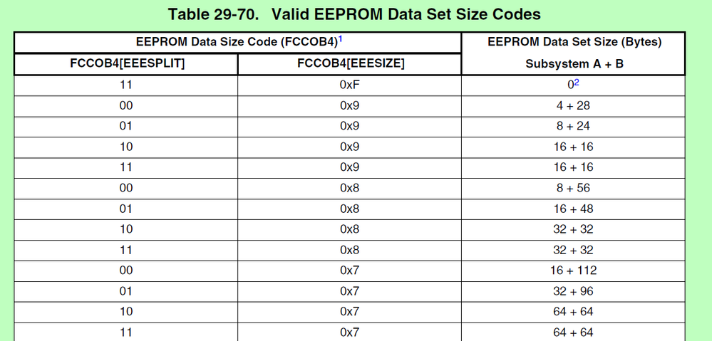

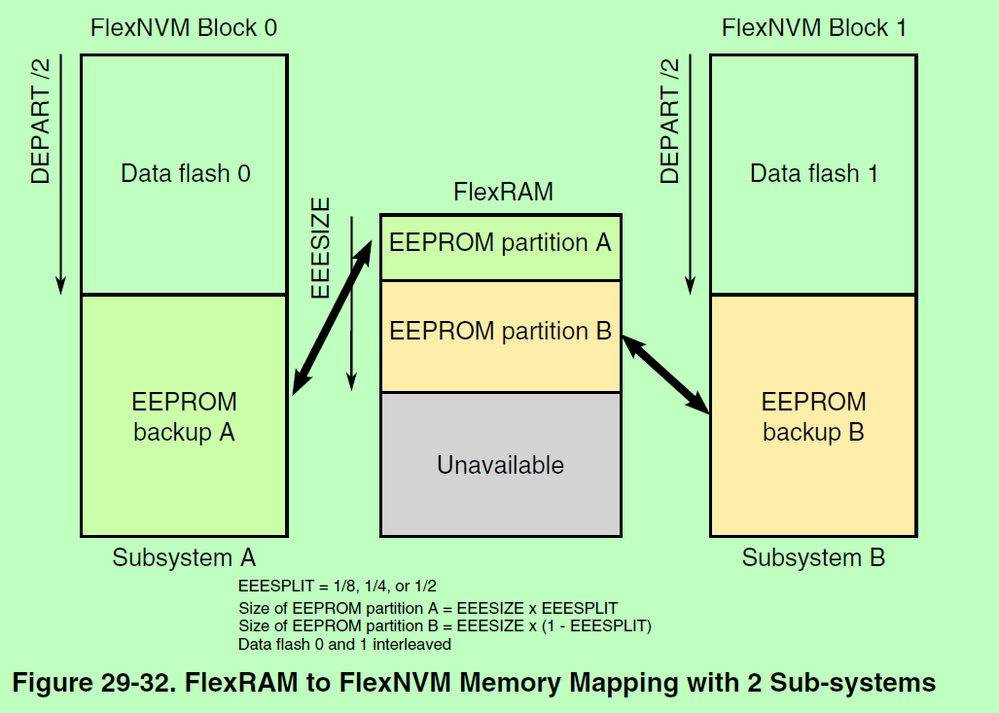

Hi Pascal,
      If you want to partition the EEPROM, you can't partition A and B independently, because when you are use the EEPROM data size code, you will partition the size of subsystem A and B at the same time.
You can refer to the table 28-70. valid eeprom data set size codes in  our reference manual K12P64M50SF4RM.PDF, the reference manual link is :
http://cache.freescale.com/files/32bit/doc/data_sheet/K12P64M50SF4.pdf?fasp=1&WT_TYPE=Data Sheets&WT_VENDOR=FREESCALE&WT_FILE_FORMAT=pdf&WT_ASSET=Documentation
      But you can use subsystem A and subsystem B independently after you do the partition, because the address of subsystem A and subsystem B is your EEPROM's address in fexRAM.
For example, if you select FCCOBE[EEESPLIT]=10, FCCOB4[EEESIZE]=0X09, then your EEPROM data set size(Bytes) subsystem A+B =16+16.
Your eeprom address is from 0x1400_0000-0x1400_001f, your subsystem A is from 0x1400_0000-0x1400_000f, subsyste B is from 0x1400_0010-0x1400_001f.
When you want to swith from A to B, just change the address.
  Wish my answer useful to you!
  If you still have quesiton, please contact me!
(Jingjing)

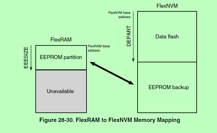

kerryzhou
Hi Pasal Schroeer,
    Thank you for your question in our community!
    Could you tell me the full name chip which you are used now?
    EEESPLIT bits combine with EEESIZE bits is used to partition the eeprom data size.
    Take K60 100M chip as an example, valid eeprom data set size codes is like following:
It is different with the MK10DX128VLH7, MK10DX128VLH7's eeprom data size code is like following:
FCCOB[5:4]=11 in K10 is according to the FCCOB[EESPLIT] in K60 100M.
If you want to partition the K60 100m eeprom , you must pay attention to the eesplits, it is very important to partition the eeprom. Your subsystem A and B is the EEPROM partition A and EEPROM partition B, EEPROM partition A+ EEPROM partition B is your real EEPROM's size.
  Please give me your full name of your chip, I will give you a reference code.
Waiting for your reply!
(Jingjing)

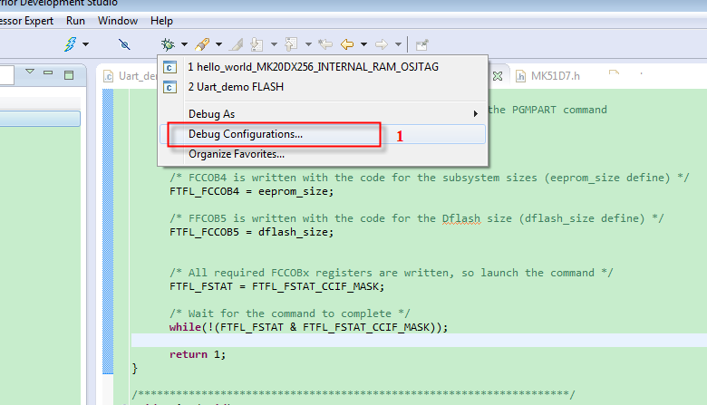

8,775 Views
kerryzhou
Hi Pascal,
     That's very easy, just don't click the hook in the debug configuration, please see the following picture:
after that click OK, then your code will not be mass earse every time when you download your code.
Wish it helps you!
If you still have question, please let me know!
Jingjing
8,775 Views
pascalschröer
Contributor V
Thanks for this description but the problem keeps the same. When I press the apply button
to confirm these settings, I'm not able to debug.
But I have good news! Yesterday I found a way to work with this CodeWarrior bug.
If you are interested in the solution please look at this topic:
Strange behaviour of the Advanced Programming Options
Thanks a lot for your help! Now I'm waiting for the freescale CodeWarrior
developers. Maybe they will find a bugfix.
Pascal
