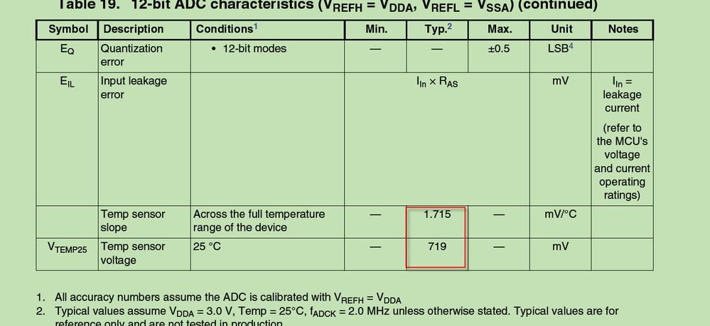

        I think your temperation 37 C is not normal, so I Check your code, it has some problems.
      Your ADC_m and ADC_temp25 is not right, because you use the wrong temp sensor slop and the wrong Temp sensor voltage, you should refer to the KL05 datasheet instead of the AN3031, an3031 is just for HCS08.
    The correct temp sensor slope and temp sensor voltage is as follows:
    Please modify your code and test again.
Wish it helps you!
If you still have question, please contact me!
(Jingjing)

I was wrong in choosing Temp Sensor Slope. I check The Temp Sensor Slope is 1.62 mV/C  typical values and VTemp25 716. I refer to this doc  KL05P48M48SF1, Data Sheet: Technical Data, Rev 4 03/2014.
Thank you for this point , I understand the Temp Sensor Slope.

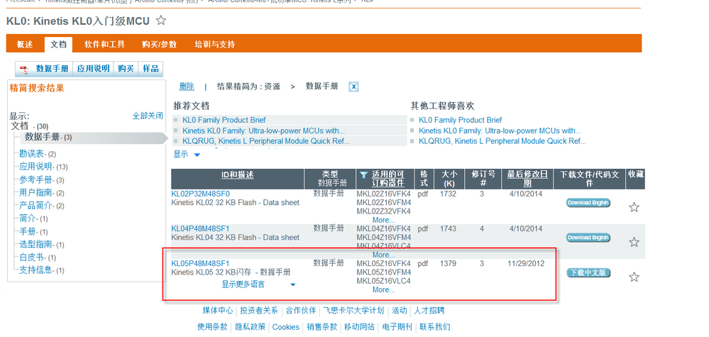

kerryzhou
Hi Minh,
  Do you have KL05P48M48SF1, Data Sheet: Technical Data, Rev 4 03/2014.?
   If you have , could you give me one, I will help you test your project.
   The datasheet what I have is just KL05P48M48SF1, Data Sheet: Technical Data,Rev. 3, 11/29/2012
  Our web situation is like follows:
    My document's data is different to you, so please give me your rev4 document, or maybe you refer to the wrong document.
Jingjing

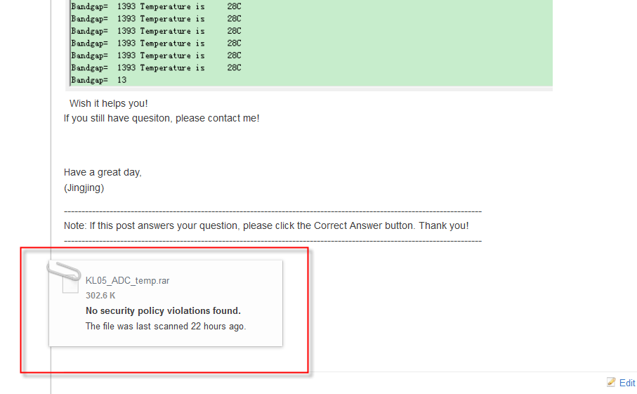

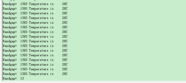

      I help you do a project, you can refer to it, please find the project from the attachment.
    I test it based on our FRDM_KL05, my test result print like following:
  Wish it helps you!

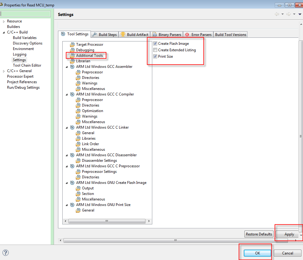

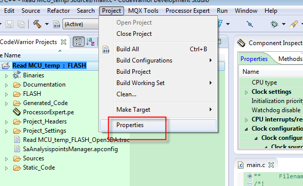

    Answer your question 1: how to see the code size
(1) Open "PROPERTIES "
(2)
(3) Build

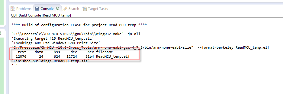

  After bulid, you will find the code size in the console window:
9,875 Views
nguyennhatminh
Hello Jingjing zhou,
Would you like explain to me more detail about information in Console Window ?
text         data bss         dec         hex       filename
13152         228             800       14180        3764     ReadMCU_temp.elf
'Finished building: ReadMCU_temp.siz'
The size of hex's file is 14180 byte =14kb , is that right ?
Thank,
Minh

     Sorry for my later reply, of course I would liket to explain it.
    Please check this link:1:[VxW] Re: What is bss, Data and Text exactly means, how it will be useful?. is there any types are t...
2:text, data and bss: Code and Data Size Explained | MCU on Eclipse
    It explain it in details.
   dec is the whole size of text , data and bss, it is decimal,
  hex is still the whole size of text , data and bss, it is hexadecimal,
