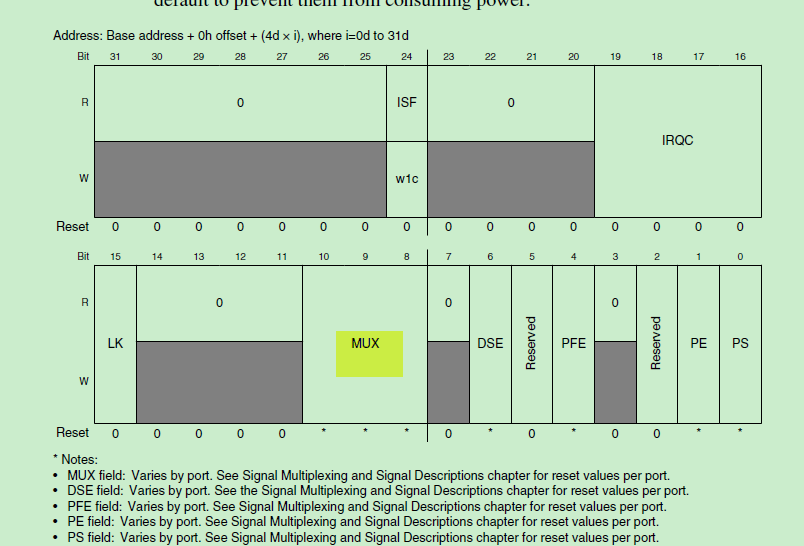

I am working on a project on the board frdm-ke15z my problem is in my code there's a function to initialize the pins with there default values. But when I run the code in debug mode (using on-chip CMSIS Debugger)at the time when I try to initialize SWD_IO pin the debug pointer is lost.
strange part is the same code runs in debug mode perfectly when I debug using J-link.
I'm not able to understand what could be the possible problem.kerryzhou

Yes the functionality I'm providing to the pin is SWD_IO only which is its default value.
I checked the PORTA_PCR4 (MUX) value with CMSIS Debugger its shows  MUX=7 (i.e. 111)  seems like its chip specific what is refers ? can you explain ?

  If you still want to use the PTA4 as the SWD_DIO, you don't need to configure it.
  Could you also please share which detail code you run then you lost the CMSIS DAP debugger?
   I highly suggest you use the NXP official code to test it at first, whether you still have the issue or not.

   What's the function you want to configure the SWD_DIO in the code? Not the SWD function?
  If yes, your debugger must be lost.
 If you still want to use the SWD_DIO pin function, you don't need to configure it, as the default function is the SWD function.
About the JLINK didn't lost issue, you can check PORTA_PCR4 register, what's the mux data now?
  Maybe the JLINK debugger even didn't modify the PTA4 mux function.
