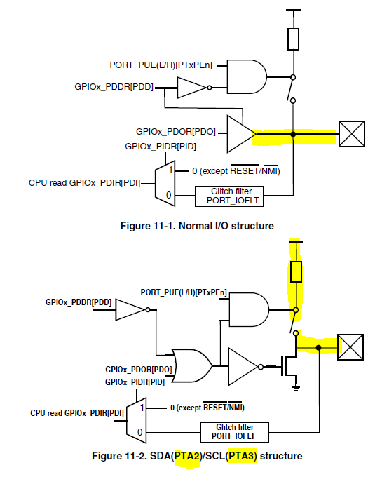

I am using the S9KEAZN64 chip, and am trying to use PTA3 as an output GPIO.  When I test the chip on a lone breakout board, setting the pin as an output GPIO, with initial value of 1, I am not reading any output voltage.  Using the same configuration on adjacent pins, both PTA2/PTA3 show no output voltage, while other pins work fine.  The documentation states that:
"All functional non-supply pins, except for PTA2 and PTA3, are internally clamped to VSS and VDD. PTA2 and PTA3 are true open drain I/O pins that are internally clamped to VSS."
I'm not entirely certain what that means, but clearly these pins are different in some way.  I attempted to enable the pull-up resistor for the pins, with the same result: no voltage output.
What is the proper way to use these pins as GPIO outputs?  Are external pull-ups required? If so, why is it not mentioned in the manual?  Perhaps I just missed it?
-Josiah

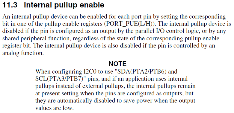

From the user's manual:
It states that on "normal" pins the pull-up is disconnected when the GPIO is used as an output (seen also form the diagram 11-1)
From my understanding of the true open drain types (according to figure 11-2) the pull-up 'should' be connected also when used as an output as long as the output is driving to '1' (when the output drives to 0 the pull-up is disconnected).
When I test I find, however, that the PTA2/3 GPIO behave as open-drain but with the normal control (that is, when configured as output the pull-up is disconnected. This doesn't correspond with the diagram.
The additional detail about them retaining their pull-up setting in I2C peripheral mode is a different question and no equivalent diagram is given for that.
Even though this detail about the pull-ups not being usable when configured as GPIO output (which may be an error either in the GPIO design or in the user's manual diagram) it is not a big issue from the point of view of the firmware. To use the pins as GPIO one can do the following:
1. Configure the pull-up and pin as output, driving 0 - this gives a low impedance '0' at the output.
2. Configure the pin as input, which gives a '1' output (through pull-up)
Each time the pin state needs to be changed switch to either output to drive '0' or switch back to input to 'drive' '1'
Therefore, it can still be used functionally as open-drian output with pull-up, without needing to add an external resistor. Just the firmware control of these 2 pins needs to be slightly different.

PTA2/PTA3 is a true open-drain pin when operated as output. It means when you control it to output low level, it output low level. If you want it to output high level, it will show high resistance state. So if you want it to output high level, you need external pullup.

mjbcswitzerland
Specialist V
Josiah

from the user's manual:
The pins do have programmable pull-ups (which are automatically disconnected when the output is driven low) so you may need to check that you are correctly activating them and also that you don't have too much load to ground that the pull-up resistor can't drive.
