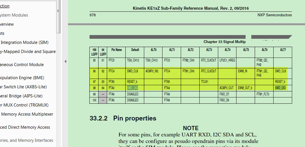

Yes the functionality I'm providing to the pin is SWD_IO only which is its default value.

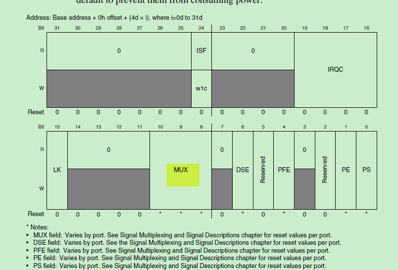

I checked the PORTA_PCR4 (MUX) value with CMSIS Debugger its shows  MUX=7 (i.e. 111)  seems like its chip specific what is refers ? can you explain ?

  If you still want to use the PTA4 as the SWD_DIO, you don't need to configure it.

 If you still want to use the SWD_DIO pin function, you don't need to configure it, as the default function is the SWD function.
About the JLINK didn't lost issue, you can check PORTA_PCR4 register, what's the mux data now?
  Maybe the JLINK debugger even didn't modify the PTA4 mux function.
