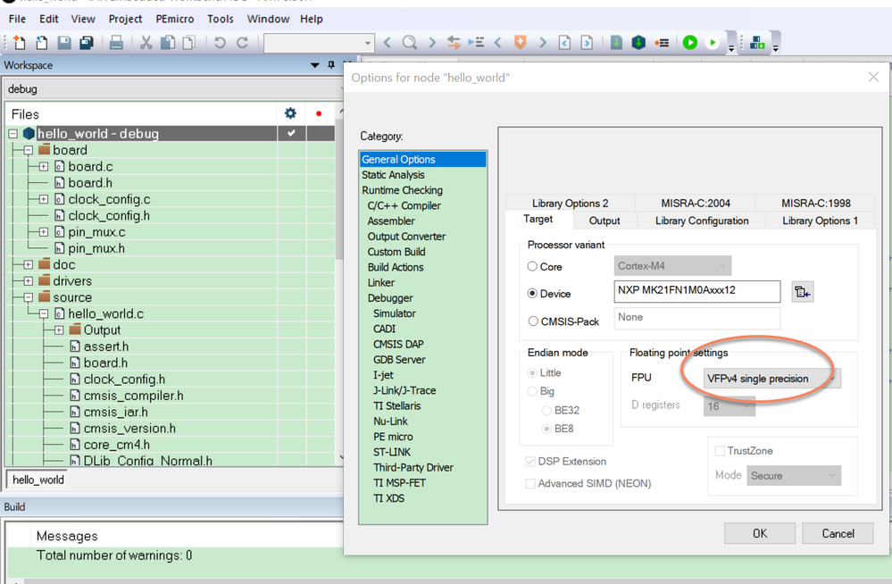

Hello.
I am working with IAR and Kinetis TWR-K21 development board,1024KB Flash, 128KB RAM.
When a function is called, which contains variables of float type, HardFault_Handler occurs. When studying this topic, I realized that I did not have a CMSIS connected (floating-point definition). After I connected the core_hm4.h file, which describes the floating-point, the function began to work, but variables of the float type in Watch show an error.
I have examples with fsl_... drivers that work with float type without any problems. I can't use this project example as a template because I don't use fsl_.. drivers. I am using my own drivers.
Is there any specific way to connect to the IAR project the CMSIS instead of connecting core_hm4.h file? (via General Options-> Library Configuration CMSIS does not work), or need to build a project from scratch with any specific definition?

kerryzhou
Hi Evgeni Kosakovski
  Do you enable the FPU on your side?
The SDK related header file is:
I think you can try the related console driver, then printf the float on your side, whether ti works with your own other drivers.
Maybe you can also refer to the SDK IAR project, then test it on your side, compare the detail difference, which one will influence your float, I didn't find any other lib for float. The K21 have the FPU, it can support the float calculation.
