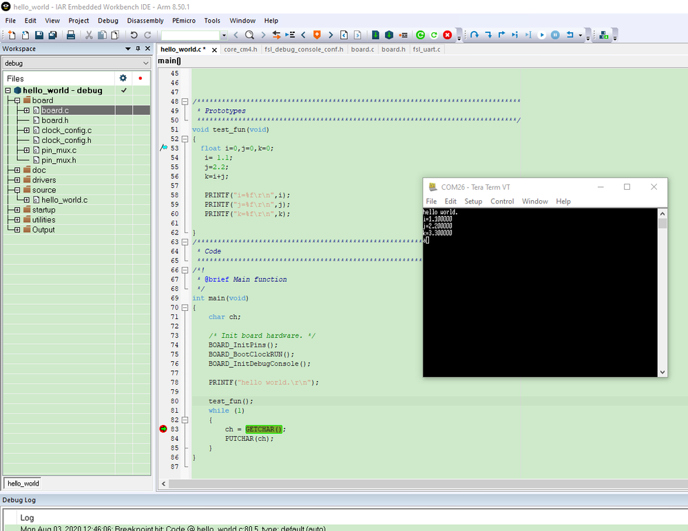

  Do you test the K21 SDK code which can be downloaded from this link:
https://mcuxpresso.nxp.com/en/select
  I have tested it on my side with the TWR-K21F120M board, the float is working.
  Just based on the helloworld project:
You also can try the NXP sdk code on your side.

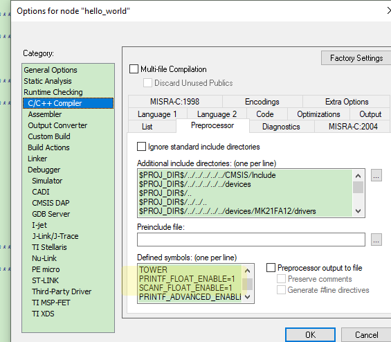

  Do you enable the FPU on your side?
The SDK related header file is:
I think you can try the related console driver, then printf the float on your side, whether ti works with your own other drivers.
Maybe you can also refer to the SDK IAR project, then test it on your side, compare the detail difference, which one will influence your float, I didn't find any other lib for float. The K21 have the FPU, it can support the float calculation.
