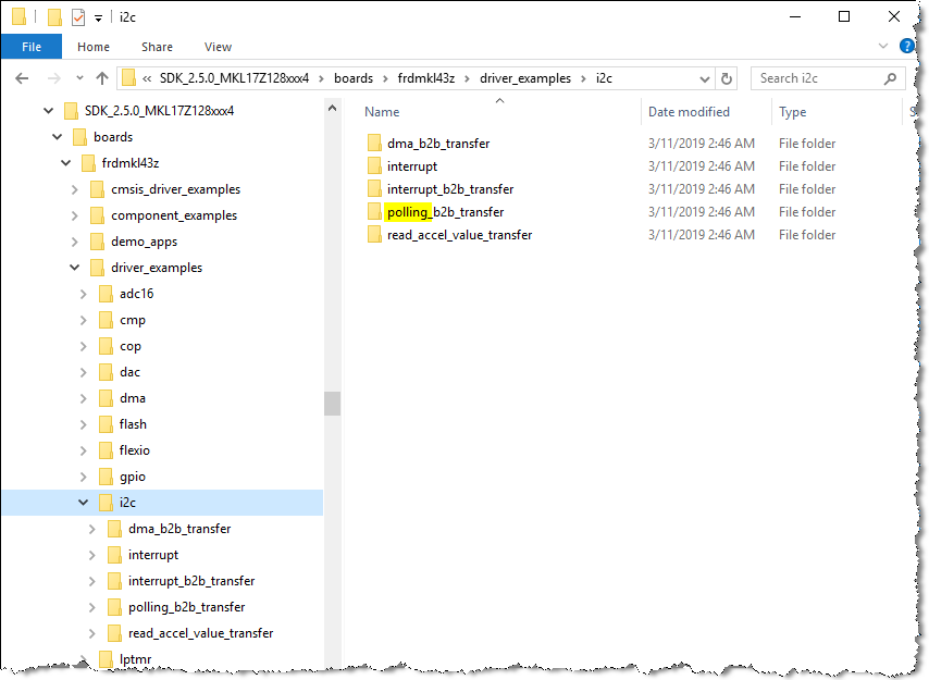

Can I transfer data through I2C without interruption?
1,085 Views
Robin_Shen
Hi  James,
No
You can find polling example in MCUXpresso SDK_2.5.0_MKL17Z128xxx4.(...\SDK_2.5.0_MKL17Z128xxx4\boards\frdmkl43z\driver_examples\i2c)
Robin
