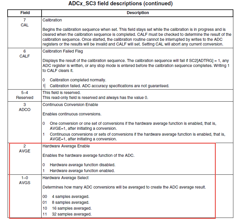

     From my own opinion,  I suggest you open the Hardware Average function,
    Take an example, if you choose 32 samples averaged, then even if you have the sudden rise of up to 5 degree, then after divide by 32, it will be just 0.15625 degree, this error should can be acceptable. Actually, just use hardware average function to filter your sudden rise up degree.

1. As I have mentioned in query, currently we are using hardware averaging of 4 which gives conversion time of 16.8us. Changing hardware averaging to 32 will make conversion time 128us and we need to monitor 6 different channels. So is this solution viable
