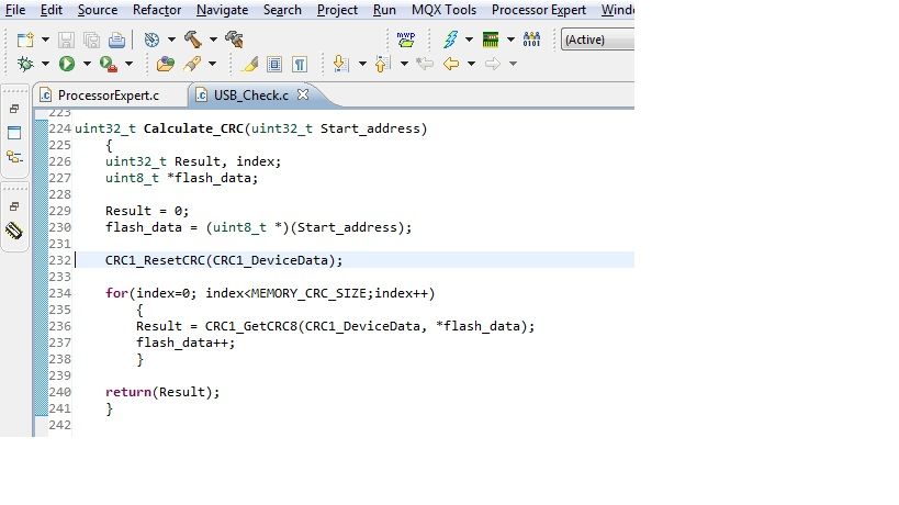

Hello to all,
I am ising the CRC module on Kinetis K60 and it works. I am not working with MQX but "only" with Processor Expert. After the initialization I only use this siple code to check all my flash program (form 0x00000000 to 0x0003F000):
Note that i am usign the CRC8 (CRC1_GetCRC8 function) only because we compare it with anoter CRC Generation code based on 8bit calculating. With Processor Expert is also available a CRC Block calculation.
Bye,
Paolo
