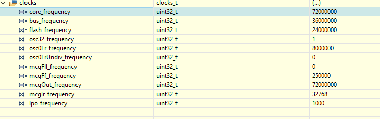

I need to init the clock for 72 MHz on the K20D72M board
The xtal is 8000000 Hz
I see on the scope it is oscillating
I use the following data structure
const mcg_config_t mcgConfig_BOARD_BootClockRUN =
.mcgMode = kMCG_ModePEE, /* PEE - PLL Engaged External */
.irclkEnableMode = kMCG_IrclkEnable, /* MCGIRCLK enabled, MCGIRCLK disabled in STOP mode */
.ircs = kMCG_IrcSlow, /* Slow internal reference clock selected */
.fcrdiv = 0x0U, /* Fast IRC divider: divided by 1 */
.frdiv = 0x0U, /* FLL reference clock divider: divided by 32 */
.drs = kMCG_DrsLow, /* Low frequency range */
.dmx32 = kMCG_Dmx32Default, /* DCO has a default range of 25% */
.oscsel = kMCG_OscselOsc, /* Selects System Oscillator (OSCCLK) */
.pll0Config =
.enableMode = MCG_PLL_ENABLE, /* MCGPLLCLK enabled */
.prdiv = 0x02U, /* PLL Reference divider: divided by 3 */
.vdiv = 03U, /* VCO divider: multiplied by 27 */
const sim_clock_config_t simConfig_BOARD_BootClockRUN =
.pllFllSel = SIM_PLLFLLSEL_MCGPLLCLK_CLK, /* PLLFLL select: MCGPLLCLK clock */
.er32kSrc = SIM_OSC32KSEL_RTC32KCLK_CLK, /* OSC32KSEL select: RTC32KCLK clock (32.768kHz) */
.clkdiv1 = 0x01130000U, /* SIM_CLKDIV1 - OUTDIV1: /1, OUTDIV2: /2, OUTDIV3: /2, OUTDIV4: /4 */
const osc_config_t oscConfig_BOARD_BootClockRUN =
.freq = 8000000U, /* Oscillator frequency: 50000000Hz */
.capLoad = (OSC_CR_SC8P_MASK), /* Oscillator capacity load: 0pF */
.workMode = kOSC_ModeOscHighGain, /* Use external clock */
.oscerConfig =
.enableMode = kOSC_ErClkEnable, /* Enable external reference clock, disable external reference clock in STOP mode */
No way. It stops here
while ((MCG->S & (MCG_S_IREFST_MASK | MCG_S_CLKST_MASK)) !=
(MCG_S_IREFST(kMCG_FllSrcExternal) | MCG_S_CLKST(kMCG_ClkOutStatExt)))
Suggestions needed.
Thank You
Pietro

pietrodicastri
Senior Contributor II
Hi Da Li
I have a hard time to find a solution. The problem with the example is that even if it works I do not see a direct way of detecting the problem in  using the SDK.
I have now found a working solution, The parameters in the SDK structure produce the right clock, but in the example the clock source for the debugging uart was the BUS clock in place of the CORE clock so it was not appearing to work.
Now it is running correctly with the modification in the SDK function.
So far I have a solution.
Thank You for supporting,
Pietro

pietrodicastri
Hi Da Li
Thank You for the suggestion. Effectively the structure of the code is totally different and difficult to analyze for exporting the logic. I tried anyway.
I found a solution just try and test. If I modify the function of the SDK
void CLOCK_InitOsc0(osc_config_t const *config)
uint8_t range = CLOCK_GetOscRangeFromFreq(config->freq);
OSC_SetCapLoad(OSC0, config->capLoad);
oscer_config_t oscer_config;
oscer_config.enableMode = config->oscerConfig.enableMode & !kOSC_ErClkEnable;
OSC_SetExtRefClkConfig(OSC0, &oscer_config );
MCG->C2 = ((MCG->C2 & ~OSC_MODE_MASK) | MCG_C2_RANGE(range) | (uint8_t)config->workMode);
if ((kOSC_ModeExt != config->workMode) && (OSC0->CR & OSC_CR_ERCLKEN_MASK))
/* Wait for stable. */
while (!(MCG->S & MCG_S_OSCINIT0_MASK))
OSC_SetExtRefClkConfig(OSC0, &config->oscerConfig );
in such way the initialization proceed correctly.  It seems it does not tolerate to have the ERCLKEN set in the OSC_CR.
There is no explanation to me. I clear the flag and I set again before exiting. I have a function to verify the results:
void clocks_dump( void )
clocks.core_frequency = CLOCK_GetFreq( kCLOCK_CoreSysClk );
clocks.bus_frequency = CLOCK_GetFreq( kCLOCK_BusClk );
clocks.flash_frequency = CLOCK_GetFreq( kCLOCK_FlashClk );
clocks.osc0Er_frequency = CLOCK_GetFreq( kCLOCK_Osc0ErClk );
clocks.osc0ErUndiv_frequency = CLOCK_GetFreq( kCLOCK_Osc0ErClkUndiv );
clocks.mcgFll_frequency = CLOCK_GetFreq( kCLOCK_McgFllClk );
clocks.mcgFf_frequency = CLOCK_GetFreq( kCLOCK_McgFixedFreqClk );
clocks.mcgIr_frequency = CLOCK_GetFreq( kCLOCK_McgInternalRefClk );
clocks.lpo_frequency = CLOCK_GetFreq( kCLOCK_LpoClk );
clocks.mcgOut_frequency = CLOCK_GetOutClkFreq();
clocks.osc32_frequency = CLOCK_GetFreq( kCLOCK_Er32kClk );
I get these results
Since I do not find the logic in it You and everyone is welcome to express.
Thank You
Pietro
