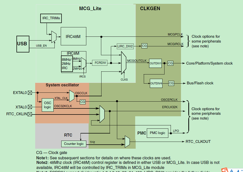

Hi all,
We have designed our custom board with MKL17Z256VFM4, with 16 MHz external reference crystal.
Is it possible to generate 48 MHz using external reference clock?
Thank you!
Felicita Mercy D.
タグ(1)
2,497件の閲覧回数
kerryzhou
Hi Felicita Mercy,
     No, you can't use the external 16Mhz crystal get 48Mhz core clock.
    Please refer to the KL17 reference manual:
    You can find the system oscillator input to the MCGOUTCLK with the CLKS choose, there has no PLL module, so the system oscillator just can be divided down, can't be doubled.
    But don't worry, if you want to use the 48Mhz core clock, you also can use the internal 48Mhz IRC.
Wish it helps you!
If you still have question, please let me know!
Kerry

Hi Kerry,
Thank you very much for clarifying.
We used internal 48MHz and it is working fine.
