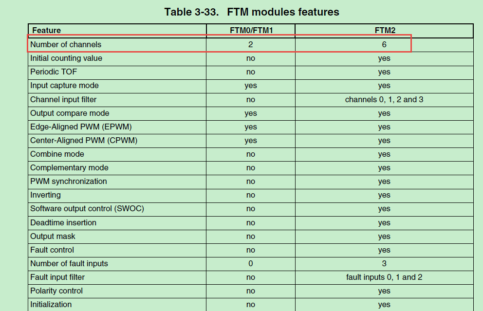

I am looking to use the 6 channel Flex Timer Module on a KE02Z32 using Processor Expert. However when I add the FTM component to my design I am only seeing 2 channels available. Does Processor Expert handle the 6 channel FTM? If so how do I access it?

Hi Robert Pflaum,
    Please check which FTM module you are using?
From the above picture, you can find FTM0 and FTM1 only have 2 channels, so, if you want to use 6 FTM channels, you need to select the FTM2 module.
Wish it helps you!
If you still have question, please let me know!
