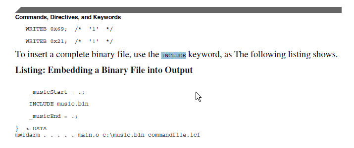

Kan_Li
Hi Edward,
I think you may build the application code into a bin file, and then use the INCLUDE keyword to merge the bin file into bootloader's image, by modify the link file for boot loader as below:
please kindly refer to D:\CW MCU v10.6\MCU\Help\PDF\MCU_Kinetis_Compiler.pdf for more details.
Hope that helps,
Kan
