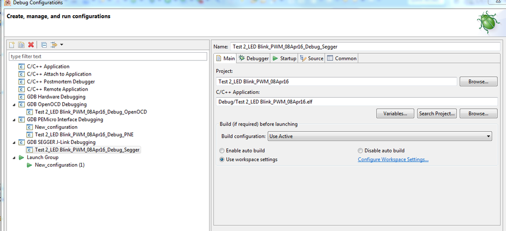

vijenad

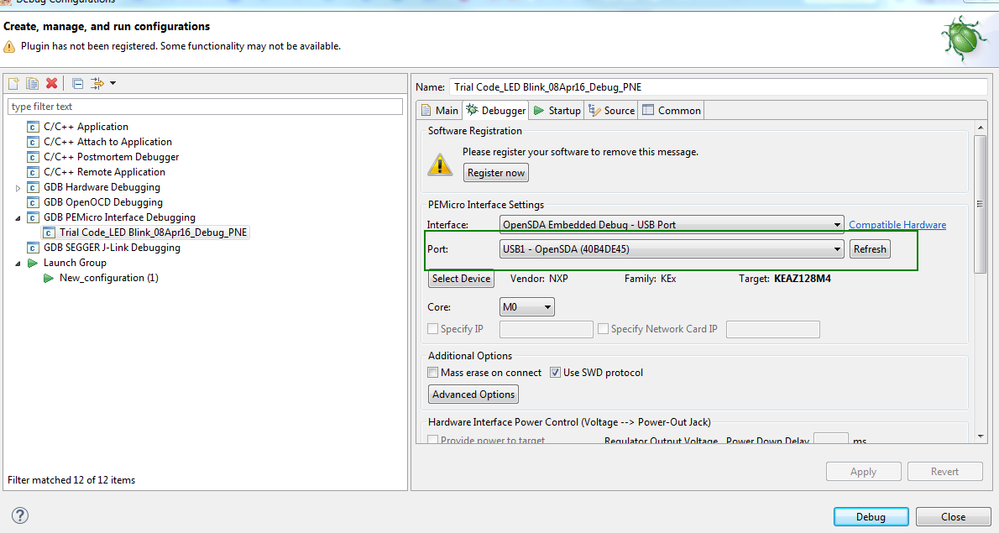

I updated KDS to version 3.2.0
Evaluation board - TRK-KEA 128
Initially I was able to debug, but I hadn't noticed configuration.
Unknowingly I made some changes and now I am unable to neither debug nor flash file on evaluation board
Evaluation board is connected directly to PC through USB port.
Need to Know
How to configure the following window "Debug Configurations"

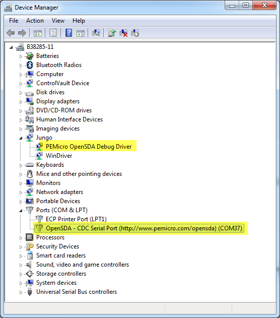

Carlos_Mendoza
Hi Vijeendra,
The connection you need to choose will depend on which firmware was loaded to the OpenSDA, you can check this by going to the Device Manager:
In this case my TRK-KEA128 board has the P&E OpenSDA firmware, so I need to choose the Pemicro Interface Debugging connection and make sure my board is recognized by the debugger:

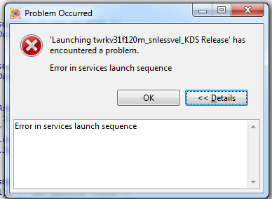

linestream-adam
Senior Contributor I
Carlos,
I'm also seeing this issue.   On Windows 7 x64 working with P&E Micro on a TWR-KV30 board.
2016-04-12 11_42_19-C_C++ - twrkv31f120m_snlessvel_KDS_src_main.c - Kinetis Design Studio - C__Users.png
I'm on the latest KDS 3.2 updated today.
I've tried cycling the USB cable, closing and reopening KDS, removing the Debug configuration.
I'm able to program this part successfully using IAR 7.4
Any thoughts?

linestream-adam
Vignesh,
What I discovered was happening was that the gdbserver wasn't closing correctly.  So I went into task manager and manually killed the gdbserver.

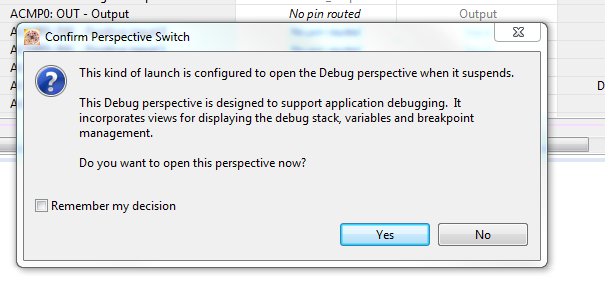

vijenad
Hi Carlos,
Is it causing any issues, I am clicking YES on it
6,317 Views
Carlos_Mendoza
Hi Vijeendra,
That should not cause any problem, that message only asks if you want to change to the Debug perspective when you launch a debug session. You can just click on "Remember my decision" and then Yes.
You can always switch back to the C/C++ perspective by clicking on this button:

Carlos_Mendoza
Hi Vijeendra,
Hope it helps!

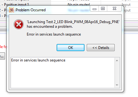

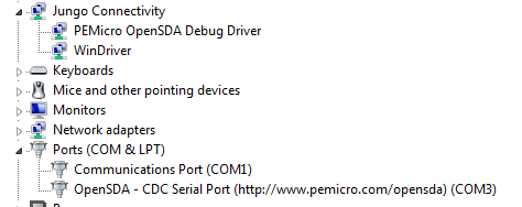

vijenad
Thanks Carlos, I thought "It helped"
But still having error.
Error 1:
Port : will be showing blank.
I need to remove and plug-in the USB cable, then I get following window
Is it required - to remove and plug-in USB cable everytime? I think some other issue in settings.
Error 2:
"Device Manager" settings :
6,317 Views
Carlos_Mendoza
Hi Vijeendra,
Please make sure to terminate the first debug session before launching a new one, if you try to launch a new debug session when there is one already running the board will not be recognized, please take a look at this thread:
KDS Debug_PNE OpenSDA disappearing port setting
Let me know if it helps!

vijenad
Hi Carlos,
I tried by restarting KDS and Error 1 got resolved.
But Error 2 is still there for me.
