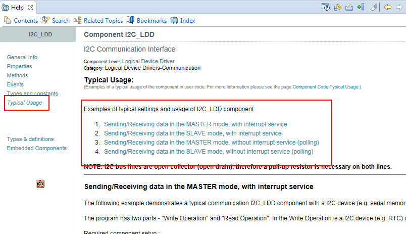

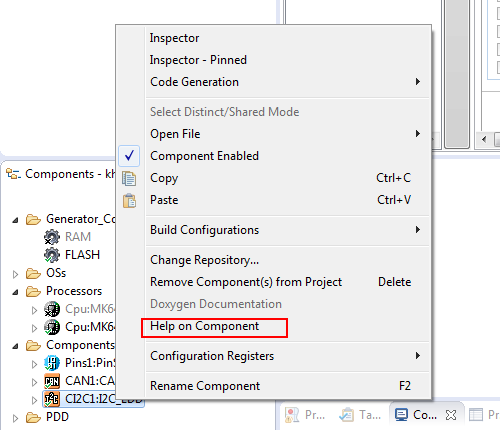

I apologize for yet another noobish question. I'm trying to use the I2C component in Kinetis to interface with a sensor, however I'm having a bit of trouble understanding how the blocks work. I tried using the example code from the "help on component" but I think I'm missing quite a bit in order to make the program function.
What I want to do is first set the 7bit address, then issue a 16bit command to start measuring data, then I would like to receive that data (3 bytes) and store it in an array, and send the acknowledges after each byte if the component doesn't do that automatically. I don't need to write to the device, other than setting the address and issuing the commands. I'm sure this is actually a simple process but I'm very lost.

Update - I have been able to confirm transmitting data to the slave and also I am receiving data, however I keep only getting the values 5, 87, and 158 repeatedly. The first 2 bytes are meant to be the data and the third is the CRC, but I'm not seeing any fluctuation on those first 2 bytes no matter what I do.
I believe my problem is that the mastersendblock only sends a 7 bit value and automatically puts the 0 at the end to designate write. This probably affects my efforts to send the two command bytes following this command. Same likely goes with masterreceiveblock.

Hello ,
I recommend you step into that function to check it stucked which place.
Please put  this question in a new thread, for this thread have past for so long ,
and people all hardly find your question , then it can not help you quickly.
Hope it helps
Alice

Hello Vitor,
It doesn't matter , i can help you step by step.
- After you configure the I2C_LDD component , if you select the "Auto initialization" option,
after generate code , you do not write slave address on the main function, all of the configure aobut
the I2C_LDD all initialized .If you uncheck this one , you can use the function
MyI2CPtr = I2C2_Init(NULL); to initialize .
- About the  usage of these functions ,there is demo , i strongly recommend you refer to them:
Hope it can helps , if still have question ,you can contact me without any hesitate.
