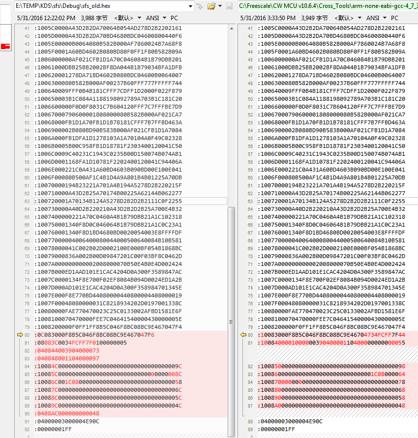

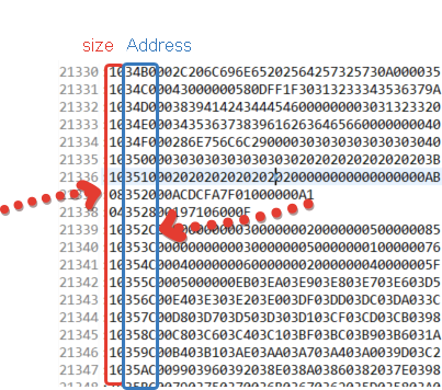

When I'm asking the KDS complier to create in addition to the elf file a HEX file there is just one critical problem : somewhere in the middle of the HEX file one of the packets size takes just 4/8 bytes and then the addresses of the rest of the file now is starting from a XXX8 and XXXC address which is not aligned anymore.
tring to program this packets on the flash returns with FTFx_ERR_SIZE (0x2000) error for the first 4 Byte packet and with FTFx_ERR_ACCERR (0x0020) error for the rest packets probably since the data is not 16 byte aligned anymore.
What is the solution for this situation? is there a simple way to enforce the compiler to create a 16 bytes aligned HEX file or i should invest more time with better robust algorithm for handeling the non-align data?

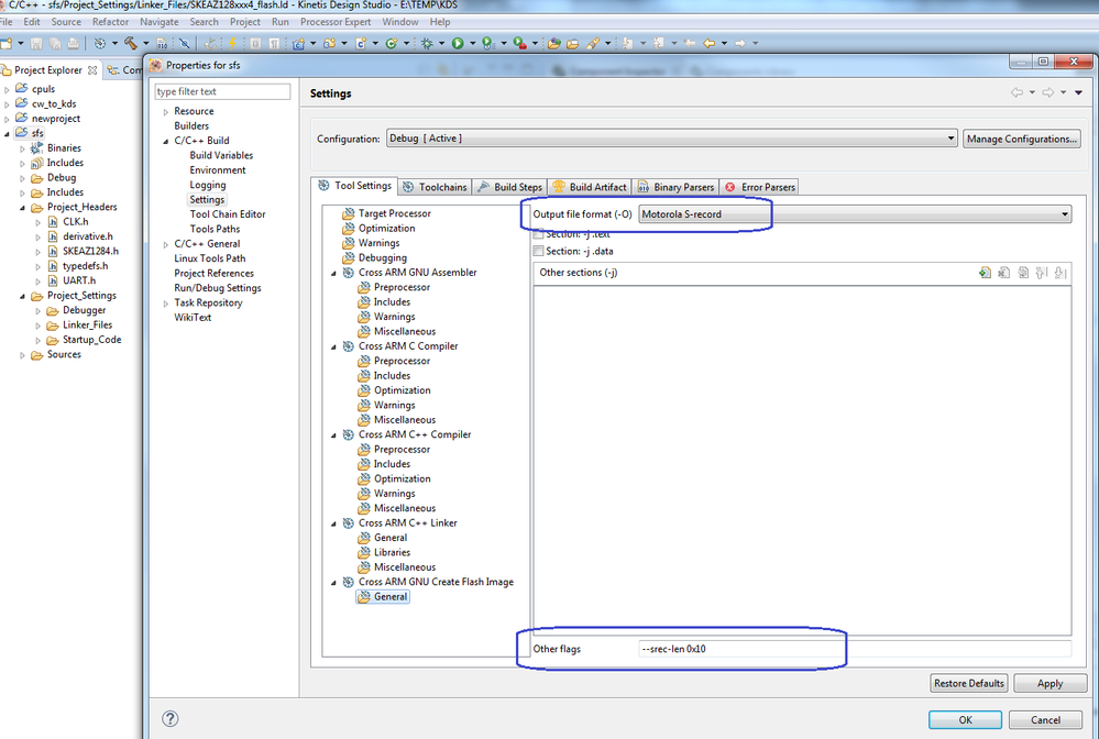

Unfortunately This tool does not support align Hex data, I found a workaround, that is to first generate S-record file as below (this tool supports to align S-record data):
Then run “arm-none-eabi-objcopy.exe” to convert S-record data into hex, like below:
arm-none-eabi-objcopy.exe -I srec -O ihex sfs.srec fixed_result.hex
This is the comparison of HEX file generated in KDS IDE,  and the one converted from S-record file.
