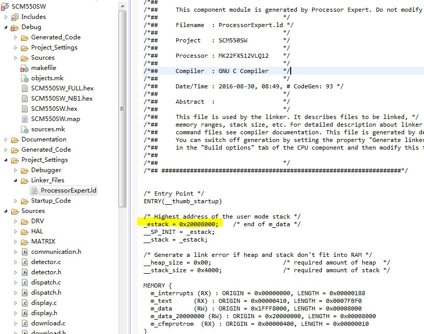

I use MK22FX512VLQ,also implement ProcessorExpert
when adreess of RAM exceed to 0x1FFFFFFF,Link fails,  the Console output says m_data overflowed, as following
But I know the RAM space end-address is 0x20007FFF,Why is the space m_data_20000000 not available?
Please tell me how to set Build Options of PE or others.  Thank you!
Further more, I modified the _estack to x20008000 in ProcessorExpert.ld, but it is no use。below is the cut of screen.

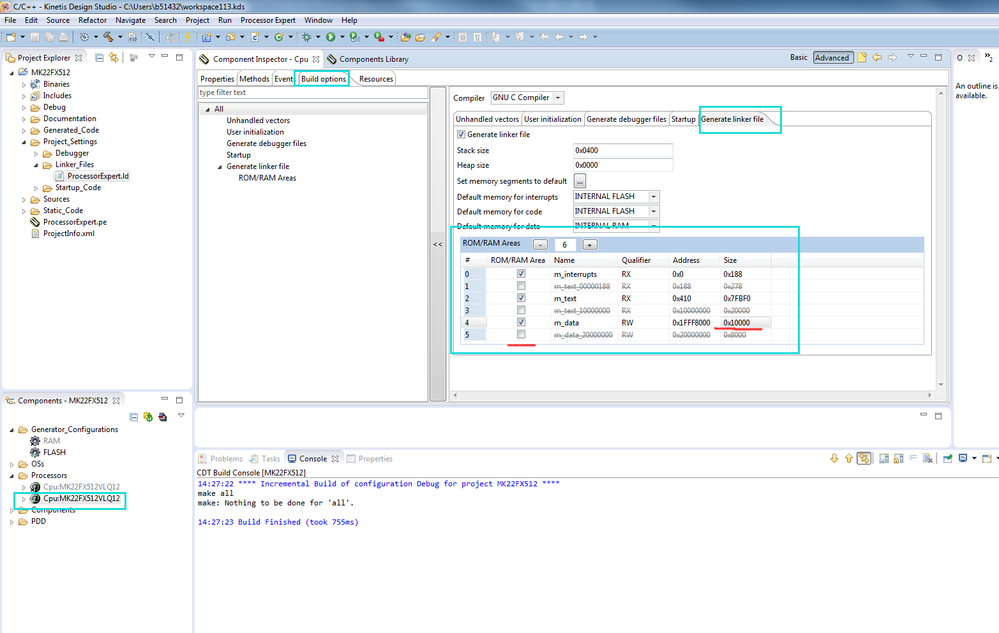

Hello JianFeng,
- For some data section ".data" ".bss".. default save int the "m_data",
not the MEMORY of "m_data_20000000", you can relocate some data or code into
this MEMORY section , refer to this DOC :
Relocating Code and Data Using the KDS GCC Linker File for Kinetis
- If you only want the project without error , not overflowed , simply, you can
merge the two section to one named "m_data" . Only need change here as the screenshot,
then generate code , build .

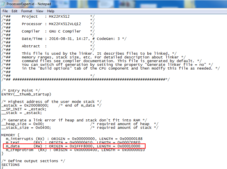

then you can see the linker file :
Hope it helps
