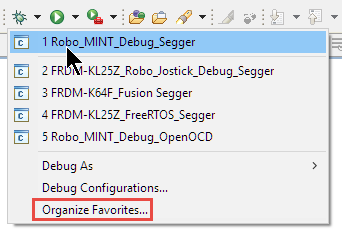

Also, how to launch debug session by single click? When I'm starting debug session, Launch Configuration Selection window always pops up and I have to select Debug_Segger configuration again and again everytime I launch debug session.
1,898 Views
BlackNight
Hi Martin,
you can create/organize favorites:
Erich
