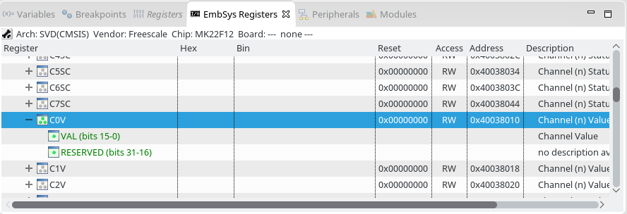

I have added register detail view in KDS like mentioned here https://mcuoneclipse.com/2014/05/29/how-to-add-register-details-view-in-eclipse/ but during debugging when I double click the register it turns out green but no value appears.
What I'm doing wrong here plz ?

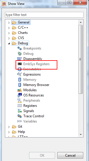

Hello Nadia,
Which version of KDS do you used?
I recommend you use the latest version of KDS v3.2 , we can directly check the register without
install anything .
You can download and install it refer to this :
New Kinetis Design Studio v3.2.0 available

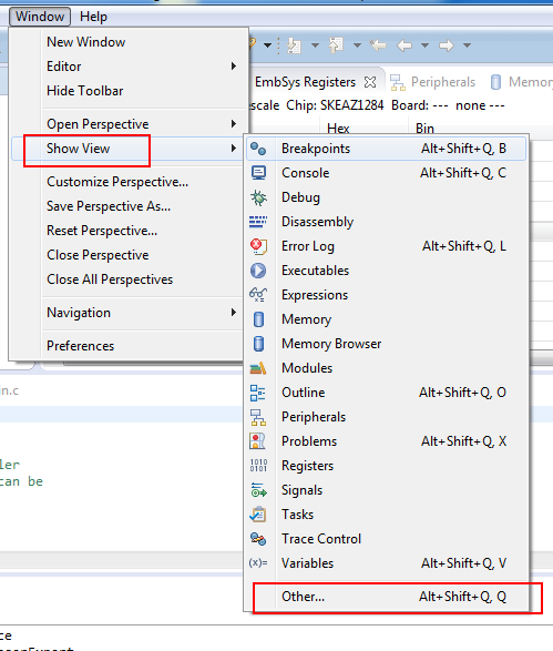

Also in the "EmbSys Registers" view to check the registers .
You can find this view on "Window -> show View->......" :

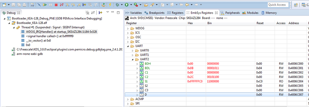

The KDS v3.2 needn't install anything when read register .
Double click the register which you want to check , it can show the data :
If you have install the Embsys Registers again refer to the thread you mentioned , i recommend
you uninstall the KDS , then install it again .
