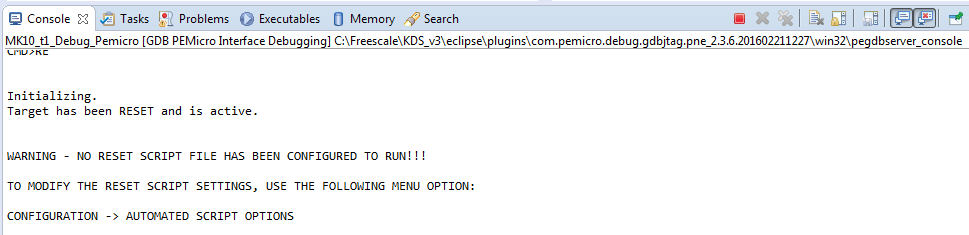

- sometimes I get a strange console message:
It looks like a message from the debugger server (GDB) that tells me to go to the menu options. I simply didn't find it.
- My first task of my project is to make sure the free running FreRTOS on my complete PCboard consumes the minimal possible current. During the hw initialization I set many pins to their proper values so that my modules on my board are switched off. After the switching-off of the modules I am stopping the MCU completely to make sure it draws the minimal possible current (using PEx Cpu_SetOperationMode(DOM_STOP,...)). The next Debug session is unable to get the MCU out of this state (I am using P&E Multilink FX with the 20-pin connection). What always helps is to press my manual reset button on the board. The JTAG TRST signal on my probe is connected. The MCU PEx configuration has the nTRST checkbox in the JTAG interface checked. It looks like the debugger is unable to get the MCU from the STOP mode.

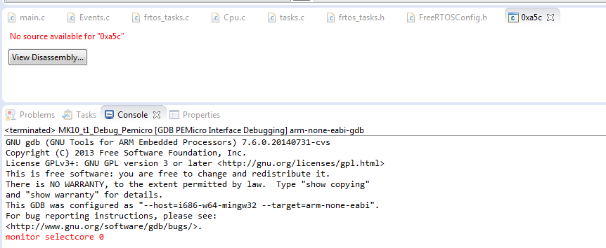

I made some progress by installing the P&EMicro update. Still, the strange "C file" with a name of 0xa5c keeps opening during every debug session.

- debugger cannot connect: check if you have another pegdbserver running (see https://mcuoneclipse.com/2015/05/18/gdb-client-and-server-unlocking-gdb/  and https://mcuoneclipse.com/2014/11/03/debugging-failure-check-list-and-hints/ ). Most of the time it is a stuck GDB server which can be killed from the task manager so you don't need to restart KDS.
- The 'no reset script file' message is a bogus message and can be ignored. This should be fixed in the latest P&E version. Check with the menu Help > Install New Software and using the P&E update site (http://www.pemicro.com/eclipse/updates ).
- STOP mode: several low power modes, including STOP are turning off the debug circuit on the device, so for the debugger it is like power is lost. You will not be able to debug through such a low power mode. This is h ow the hardware is designed.

I have read most of the articles/posts on your mcuoneclipse.com, so I am aware of most of the advices reagrding GDB. I believe I have configured the GDB with some mistakes, it behaves erratically. Right now the debugging session opens a previously unknown message with some nonexistent .c source file 0xa5c, see below.
