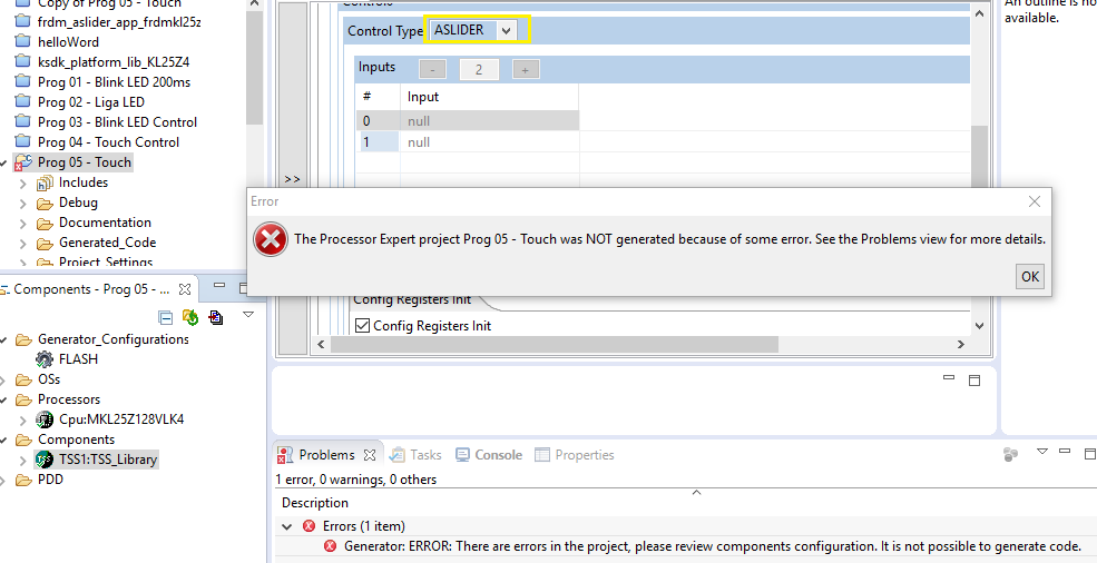

arnaldogomes
Hello Alice!
After your tips I had the following behaviour don't work to TSS_3_0. However when I chosse library TSS_3_1 and Control Type equal the ASLIDER I have other erro message (see figure bellow).
It's possible you validate the example "http://cache.freescale.com/files/videos/player/TIP_popupvideo.html?XML=/files/videos/training/genera..." using the Kinetis Desing Studio?
Thanks!
Arnaldo

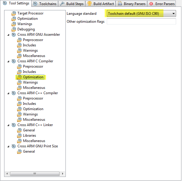

Hello Arnaldo,
I know your meaning, you want use the TSS_Library of PE driver on KDS.
Yes, it can used , while after you add the TSS component , you need configure two place:
  1. Add the TSS library to the linker options
  2. Change compiler option to accept asm("...")
Please refer to below steps to configure :
Then build the project, the error will disappeared .
Hope it helps
Alice

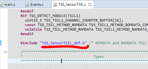

vítorpereira
Hi Alice,
I'm having the same problem described in the beginning of this thread.
I've already made the linker see the TSS_KXX_M0 library. The error persists. Looks like the only thing happening is that really there isn't the TSS_SensorTSIL_def.h file. When I double click to open the file in the Project Explorer window, under my project folder, Sources>TSS>TSS_SensorTSIL.c, it simply doesn't. The only thing it does is to show the incude Processor Expert generate in the TSS_SensorTSIL.c file.
I don't think I will be able to make it work, neither anybody else, without this file.
I can't see any other reason why it doesn't work or the compiler doesn't find it.
Hopping to hear from you.
Vítor Pereira
