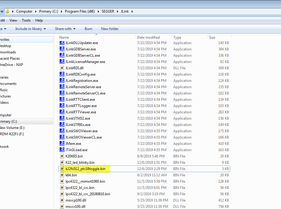

gauravmore
Hi Kerry,
I followed the process to suggested like
1. Copied the file into specified location C:\Program Files (x86)\SEGGER\JLink

kerryzhou
Hi Gaurav More,
    I just test the .bin code which I give you before, I find that KDS generated .bin have problems, that's why you can't download it.
    So, I modify the SDK for K22FX chip with IAR IDE, I write the PTD18 toggle code again.
    Please help to test it, I attached the new firmware for you.
     Because I don't have your K22 board, so I just test the .bin in FRDM-K22, check whether I can download or not, this is my result:
Please use my new firmware, and use JLINK download it to your own board again.
Any updated information, please let me know.
If you don't have the external JLINK, you don't need to buy it, because your Multilink also have problem, I think it may also related to the hardware stable problem.
You can use the FRDM-K22 on board JLINK test it at first.
kerry
